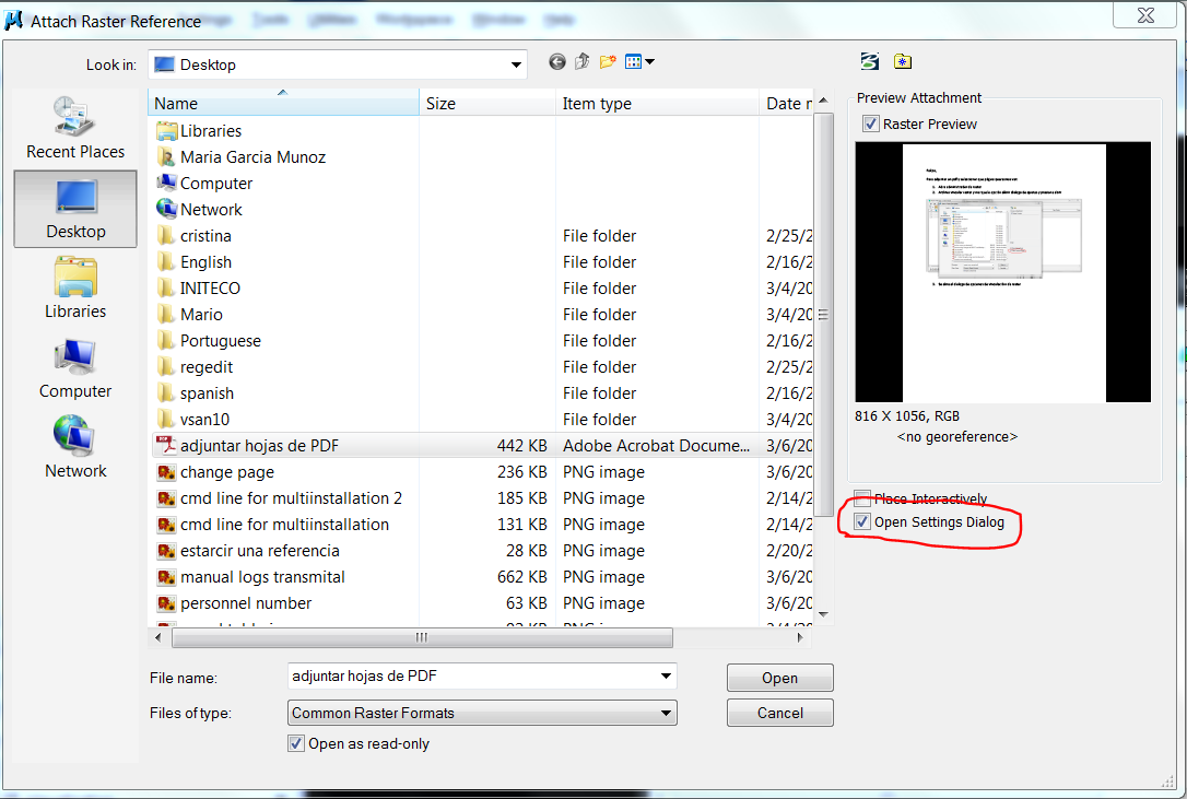

  2. File:> Attach> Raster
  3. Turn on Open Setting dialog

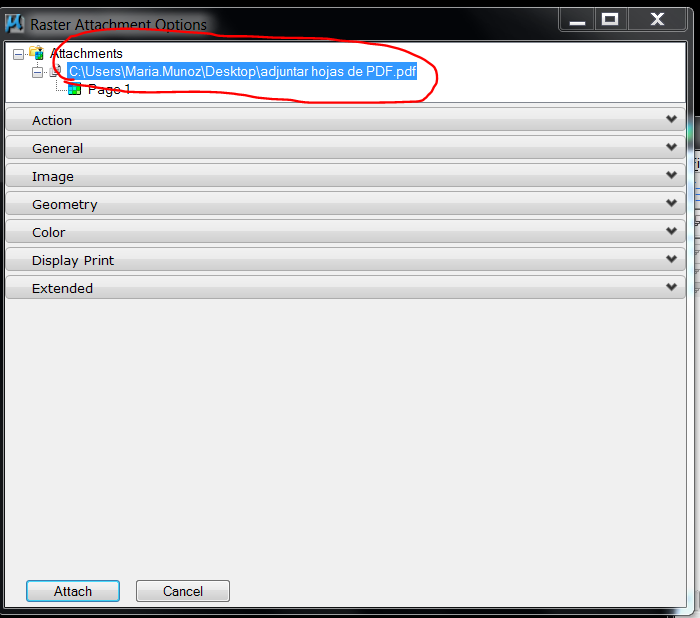

4. Raster Attachment options dialog open

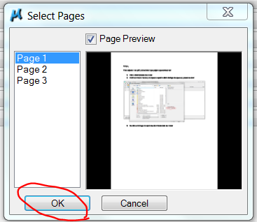

5. Right Click on top of the PDF directory
6. Select page and press ok
If changing the selected page is needed, now there is no need for detaching and reattaching PDF again like in old version, MicroStation SS3 added this possibility by doing right clicking on the PDF attached on the Raster Manager dialog and by selecting change page.
