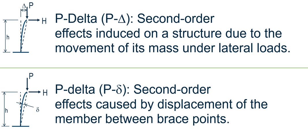

General Analysis Requirements
According to the AISC 360-16 Specification, Chapter C2.1, the second order effects (including both P-Δ and P-δ) must be considered in the analysis.
In STAAD.Pro, the second order effects (including both P-Δ and P-δ) are automatically considered when the PERFORM DIRECT ANALYSIS command is issued.

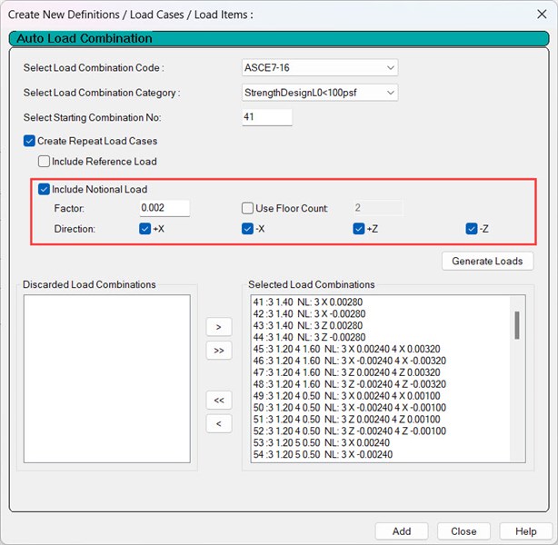

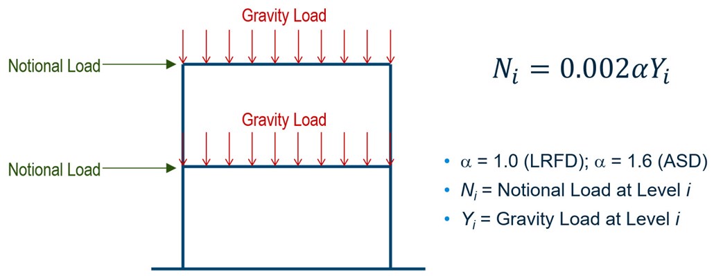

Consideration of Initial System Imperfections
According to the AISC 360-16 Specification, Chapter C2.2, the initial system imperfections must be considered when calculating the required strength of the lateral steel members by either directly modeling the imperfections or by applying notional loads. Notional loads are a portion of the gravity load acting on the structure horizontally. The notional load factor shall be calculated according to the AISC 360-16 Equation C2-1.
In STAAD.Pro, notional loads (along with the appropriate notional load factors) can be generated through the Automatic Load Combination Generator.
NOTE: When specifying the notional load factor, ensure that you consider the design method (LRFD or ASD) along with the method you plan to use to calculate tau-b (iterative vs. non-iterative solution).

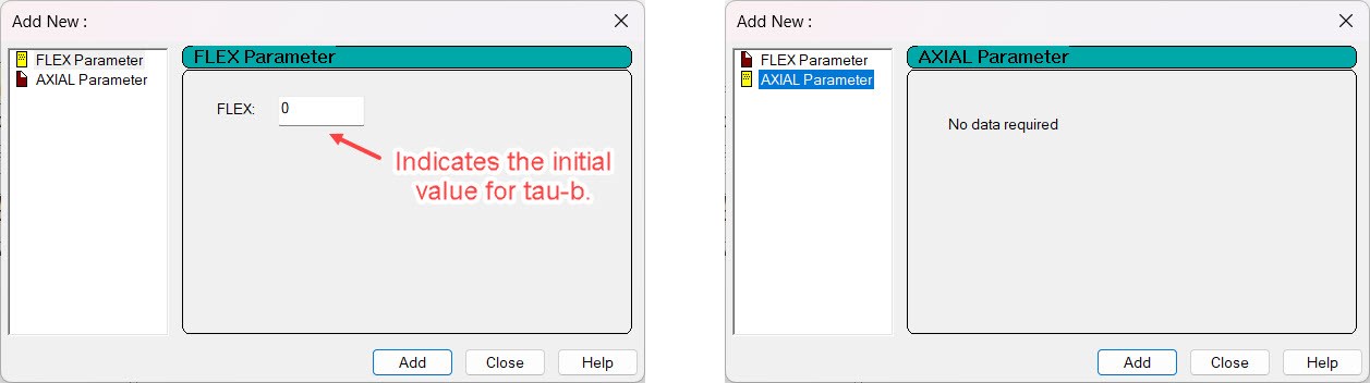

Adjustments to Stiffness
According to the AISC 360-16 Specification, Chapter C2.3, indicates that the flexural and axial stiffness shall be reduced for the members that contribute to the lateral stability of the structure. The stiffness reductions will consider the inelastic effects due to residual stress and the uncertainty in strength and stiffness. The reduced flexural and axial stiffnesses shall be calculated as follows:

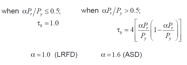

τb, which is dependent on the level of axial stress, can be calculated according to the AISC 360-16 Specification, Equations C2-2a and C2.2b):
It is also permissible to assume τb equals 1.0 if the additional notional load of 0.001 times of gravity load is applied.

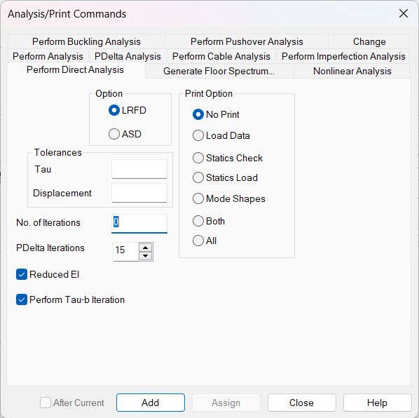

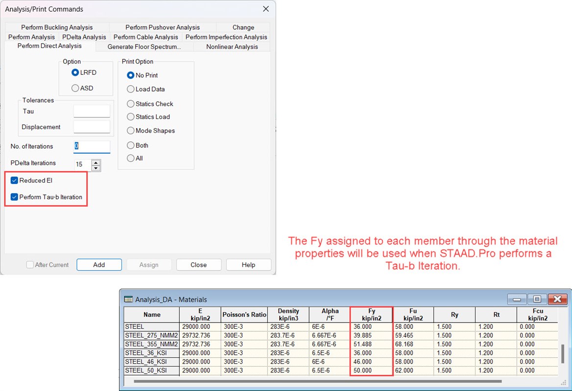

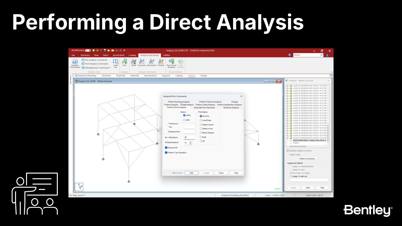

In STAAD.Pro, a Direct Analysis Definition is used to instruct the program to reduce the stiffness for the steel members in accordance with the AISC 360-16 Direct Analysis Method, as follows:
STAAD.Pro can perform an iterative solution for τb if specified in the PERFORM DIRECT ANALYSIS command. If you are performing an iterative solution for τb x EI), STAAD.Pro will use the yield strength of steel, as specified in the materail properties, to calculate τb.
Performing a Direct Analysis on Bentley Learn:
Learn how to perform a direct analysis in STAAD.Pro according to the AISC 360, Chapter C, on Bentley Learn:
