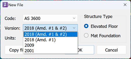

AS 3600-2018 Amendment #2
AS 3600-2018 Amendment #2 is now implemented.
Refer to the chapter titled AS 3600-2018 Design in the RAM Concept manual for detailed notes on the implemented design code changes.
To use this design code in new files, open the New File dialog and select AS 3600 in the Code menu and 2018 (Amd. #1 & #2) in the Version menu as shown in the image below.
To select this code in existing files, open the Calc Options dialog and select AS 3600-2018 Amd. #1 & Amd. #2 in the Design menu.
The currently implemented AS 3600-2018 (Amd. #1) version remains implemented as a separate design code selection.

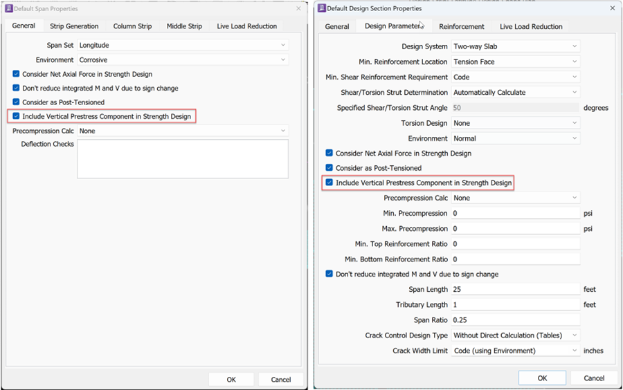

Option to Include Vertical Prestress Component in Strength Design Calculations (available for AS 3600-2018 Amd. #1 & Amd. #2 only)
The vertical prestress component (Pv) can now be considered in the Strength Design checks for the AS 3600-2018 design code.
The option to include this component is available in the Span Properties and Design Section Properties dialogs as shown in the images below.
When included in the design, Pv is factored by 0.9 if it acts to reduce the design shear and by 1.15 if it increases the design shear per clause 8.2.1.3 or changes its direction.
Pv forces are summed with the design force envelopes during the shear envelope conversion. The resulting summed shear value including Pv is the shear demand value used in the design calculations and output in the section analysis tables and plots.
The option is disabled and Pv is ignored if the Consider as Post-Tensioned option is not selected.

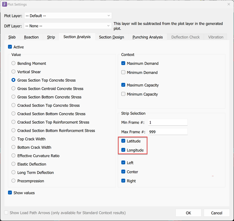

Plot Settings – Strip Selection Filter for Latitude and Longitude Span Sets
Plotted design strip results can now be filtered by latitude and longitude span sets using the Strip Selection filters in the Plot Settings dialog that are marked in the image below. For example, when the Latitude box is checked and the Longitude box is unchecked, only strip results for the latitude design strips are displayed.
The new Strip Selection filters are available for Strip, Section Analysis, Section Design, and Deflection Check results.

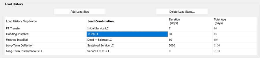

Load Combination Identified by ID Number in Load History Table
In the Load History Table, load combinations defined with non-zero standard factors for both the Balance and Hyperstatic Loading were identified by an internal ID number instead of the defined load combination name as shown in the image below.
Ram Concept is designed to exclude all load combinations that include the Hyperstatic Loading as selections in the Load History Table. This problem only occurred when a load combination was referenced in the table and the Hyperstatic load factor for that combination was later changed to a non-zero value. When this issue occurred, all calculations were completed using the correct load combination with its unexpected load factor for the Hyperstatic Loading.
RAM Concept now prevents changes to the Hyperstatic Loading load factor if the load combination is referenced in the Load History table. The error message displayed in the image below is displayed when this change is attempted.

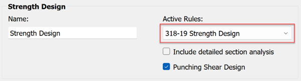

Punching Shear Checks Completed after Setting Active Design Rules to None
Punching shear calculations may have been completed when a Strength Design Rule was defined with the Punching Shear Design box checked and the Active Rule selection was changed.
Punching shear design is now disabled when the Active Rule selection is changed from Strength Design.
