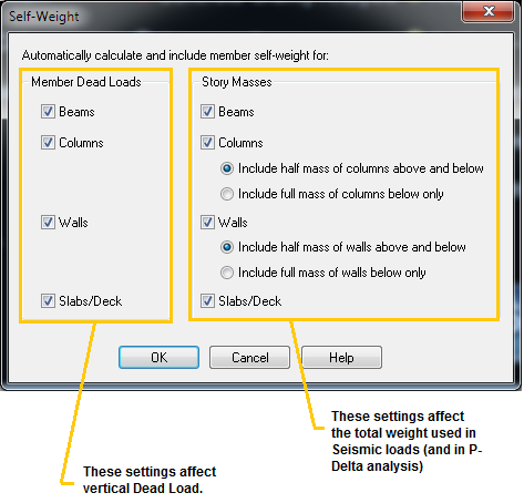

Is the structure self-weight included in the loads?
That depends on the settings under RAM Manager - Criteria - Self-Weight. Here the user can automatically include beam, column, wall or deck self-weight. Note, self-weight is never included for open web steel joists or vertical braces.
On the right hand side of the dialog box are the settings for self-weight as it applies to the building mass which is used for seismic loads, dynamic analysis and for P-Delta calculations.
For composite beam design, the self weight is always considered part of the Construction Dead Load. Hence, if all the self weight options are turned on, and there is no other load present during construction, the user applied CDL might be zero.
For open web steel joist systems it's important to note that no self-weight is applied for the steel joists. The reason for this is primarily that the unit weight of steel joists can vary depending on the manufacturer and the configuration of the diagonals. The user should always include extra dead load in the surface loads to account for estimated joist self weight.

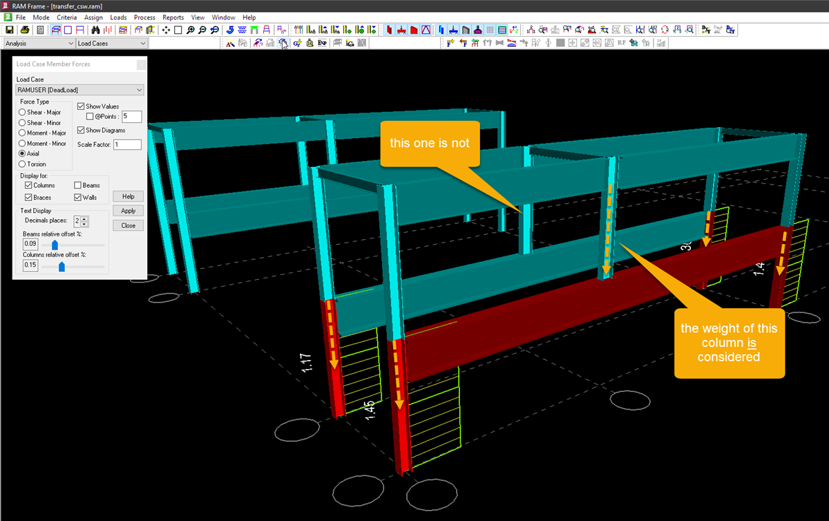

In order for the steel gravity beam and column self weight mass to be considered in RAM Frame, it is imperative that those modules be run first, using the design-all process. So long as the RAM Manager indicates a green light next to each of those modules, RAM Frame should have the latest member self weight data available. Freezing the design of all gravity beams and columns is another way to ensure that member self weights are always considered.
Steel column self-weight is based on the column length from story to story, plus or minus any elevation offsets, times the section area and steel density. We do not increase the self-weight based on splices being a few feet above the story datum.
The self-weight of steel gravity columns is not included in the design of a steel gravity transfer beam that supports a column above. This is true because the design of the beams typically happens prior to the design of the steel columns. (In Ram Frame, the column self-weight is applied for the case of a steel gravity column setting upon a lateral beam, assuming that steel column design took place first (green light).

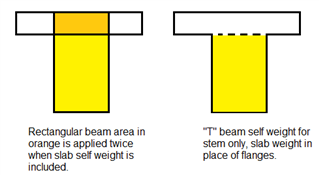

How is the self weight of a Concrete Beam determined?
The program calculates rectangular beam unit self-weight based on the area of the beam times the "Unit Weight of Self weight". The other "Unit Weight" parameter is only used in calculating the elastic modulus, E, of the member.
The Concrete slab can independently be included in the self weight, so in cases where there is a concrete slab and rectangular concrete beams the weight of the concrete times the thickness of the slab and the width of the beam is double counted.
To alleviate this problem, "T" shaped beam sections are handled differently. With T-beams, it's only the rectangular area of the stem below the flange that is applied as the beam self weight.
This also applies to the material take off report in the Concrete Beam module.
Exclusion of the T-beam flanges from the self weight is based on the thickness of the flanges. Normally, in a one-way deck scenario, the flange width and thickness are both determined by the program, but the user can specify the flange dimensions in the Modeler - Properties Table - Concrete Beam sections.
It is usually not advised to mix T-beams and 2-way decks together since the stiffness of the flange is then "double counted".

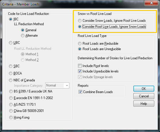

Why are my Roof Live loads ignored in the design?
Starting in version 2026, Roof Live Loads and Snow loads are both considered in the design in a single pass along with the various floor live load types. For members that resist multiple types of live load, the program now includes code-specific combinations for those effects. For the current AISC and ASCE 7 designs, the load factor on the snow load is reduced compared to older code to account for the "ultimate" nature of the loads. Refer to the RAM Steel Beam manual for details on the load combinations considered in RAM Steel Beam and Column.
RAM Structural System previously considered Snow OR Roof LL, but not both at the same time. In RAM Manager under Criteria - Members loads there was a toggle to select which the program should consider. Set the toggle to "Consider snow loads, Ignore roof live loads" when snow loads are modeled.
Note: Live Reducible, Unreducible and Storage type loads are always considered, it is only the Live - Roof type loads that are excluded when the option to consider snow loads is turned on.

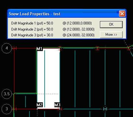

How can I apply a drift snow load?
Within the snow loads, only the top load counts. Since only the top snow load counts, the drift snow load should typically taper down from the max value to the flat-roof snow load as a minimum. The program gives a warning when any portion of the sloping plane of snow load is 0 or less magnitude.
In general, it's best to define snow drift loads with M1 and M2 set to the highest value, and M3 set to the flat roof level. Then the loads can be applied in rectangular or trapezoidal areas as required. In the image below, the total snow load on the left is 50 psf tapering down to 30 psf on the right. This would be used in conjunction with a flat roof snow load of 30 psf applied first to the whole roof.
