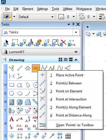

 In MicroStation V8i:
Points Tools are located under Tasks > Drawing > Linear tools:

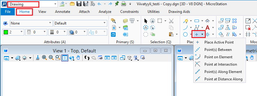

In MicroStation CONNECT Edition:
Points Tools are located under Drawing workflow > Home tab > Placement tools:

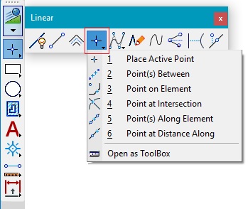

 Or Task lists > Linear > Points
