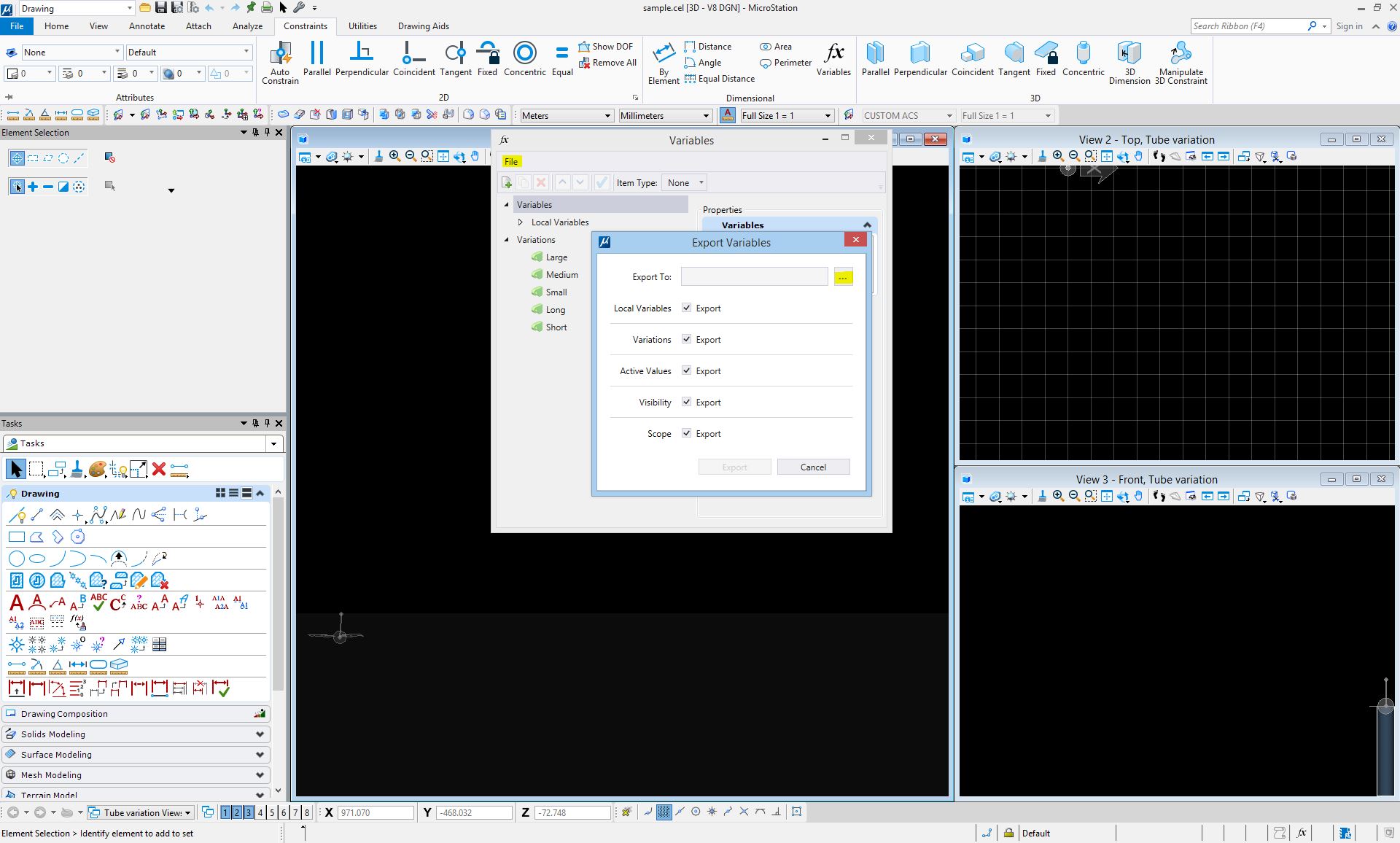

Variables and variations created to control parametric cells can be exported to a CSV file for backup or further manipulation.
Open the Contraints tab and click on Variables
Click on File > Export
Browse for the path in which to save the file and then click on Export
The CSV can then be imported back to the original file or into a new file. Note the optional 'Clear Existing' boxes, ticking these boxes will remove existing local variables.
