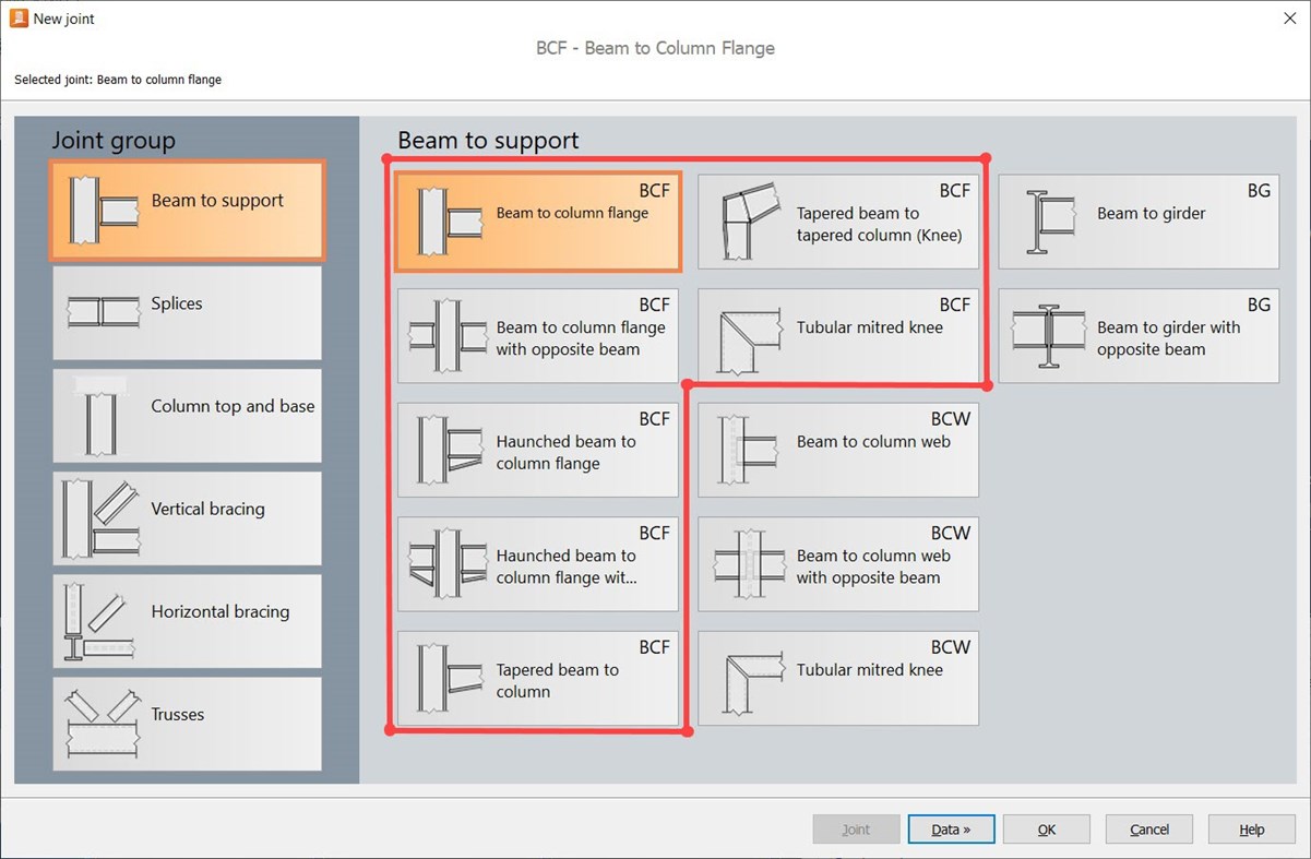

Beam - Column Flange Connections
Beam - Column Flange Joints
In RAM Connection, Beam - Column Flange (BCF) Joints can be created with the following configurations:

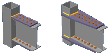

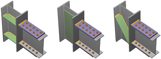

  • AISC: Flange Plate (FP)
  • AS: Flange Plate (FP)
  • CSA: Flange Plate (FP)
  • GB: Flange Plate (FP)
  • NZS: Flange Plate (FP)
  • I-Shaped
  • Rectangular
  • I-Shaped
  • Beam Skew Angle: Max 60º
  • Beam Slope Angle: Max 45º
  • Connection Type: Bolted or Welded

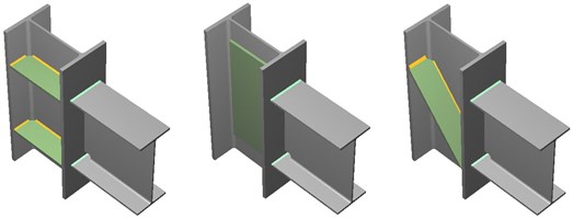

  • Stiffeners: Transverse Stiffeners and/or Web Panels
  • Wrap-Around Plate: Optional for Rectangular Columns for the AISC Specification
  • Diaphragm: Optional for Rectangular Columns for the AISC Specification.

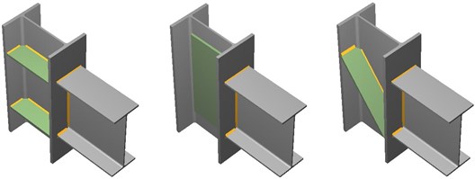

  • AISC: Directly Welded (DW)
  • BS: Directly Welded (FW)
  • EN: Flanges Welded (FW)
  • GB: Directly Welded Flanges (DW)
  • I-Shaped
  • Rectangular
  • I-Shaped
  • Stiffeners: Transverse Stiffeners and/or Web Panels Optional

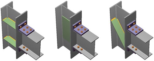

  • AISC: Moment Angle (MA)
  • IS: Moment Angle (MA)
  • I-Shaped
  • I-Shaped

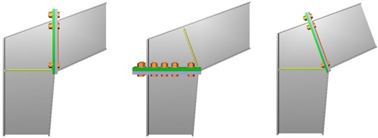

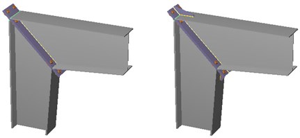

  • AISC: Moment End Plate Knee (Knee)
  • Tapered I-Shaped
  • Tapered I-Shaped
  • Connection Configurations: Vertical, Horizontal, Perpendicular
  • AS: Mitred Bolted End Plate (Mitred)
  • CSA: Bolted End Plate (Mitred)
  • NZS: Bolted End Plate (Mitred)
  • I-Shaped
  • Tapered I-Shaped
  • I-Shaped
  • Tapered I-Shaped
  • Haunched I-Shaped
  • Stiffeners Optional

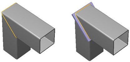

  • AISC: Mitred Knee HSS (MKHSS)
  • AS: Mitred Knee HSS (MKHSS)
  • CSA: Mitred Knee HSS (MKHSS)
  • EN: Mitred Knee HSS (MKHSS)
  • NZS: Mitred Knee HSS (MKHSS)
  • Rectangular
  • Circular
  • Rectangular
  • Circular
  • Stiffening Plate Optional

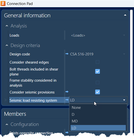

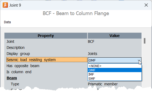

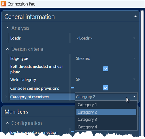

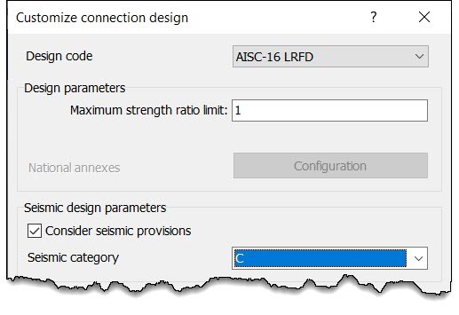

Seismic Provisions for BCF Moment Frames
In RAM Connection, seismic provisions can be incorporated into the design of the following connection templates:
Design Codes
The seismic load resisting system and seismic design parameters (including reduced beam sections) can be specified for moment resisting BCF joints where seismic provisions are considered:

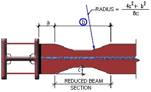

Reduced Beam Sections
The reduced beam sections follow the recommendations of the following seismic design standards:
