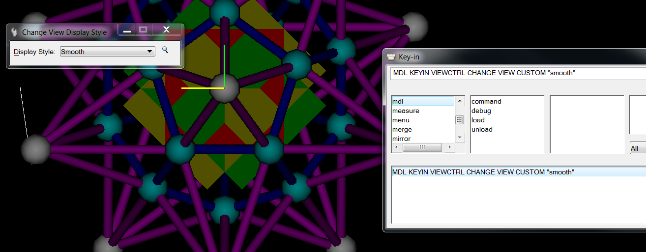

A quick method to navigate between Display Styles e.g.Wireframe and Transparent with Shadows.
The following Keyin changes the view from Wireframe to Smooth Shadows:
change view custom "Smooth:Shadows" 1
Where CHANGE VIEW CUSTOM starts the actual command.
Where "Smooth:shadows" is the name of the Display Style.
Where 1 is the view number.
Display styles can also be edited/created using:
Settings> Display Style.
