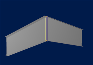

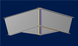

2. New AISC360 directly welded connections for knee and apex joints for tapered and haunched beams.
Beam to column directly welded connection (knee joint)
Beam splice directly welded connection (apex joint)
