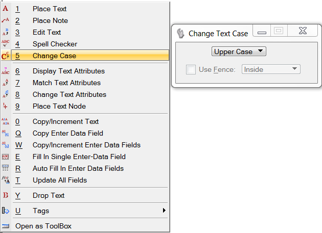

Is there a tool to change the case of text?

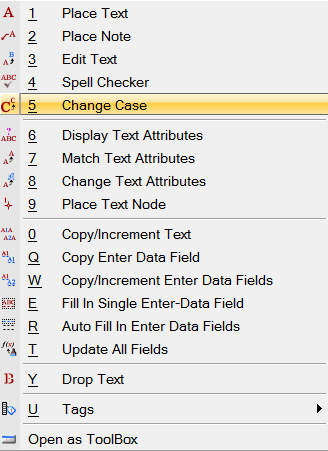

In MicroStation V8i, the case can be changed via the Word Processor. Select your text and Right click and choose Change Case from the pop-up menu.
Alternatively, Go to the Tools menu > Text > Change Case.

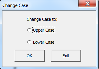

In order to change the case of your text in MicroStation V8
Utilities > Keyin > vba run [textexamples] changecase
The following dialog will then open:
