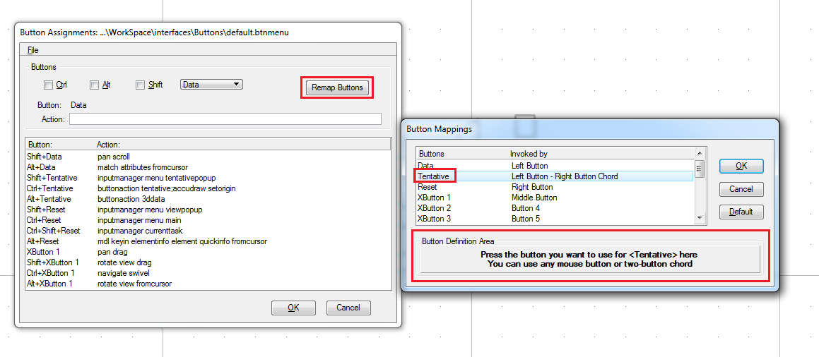

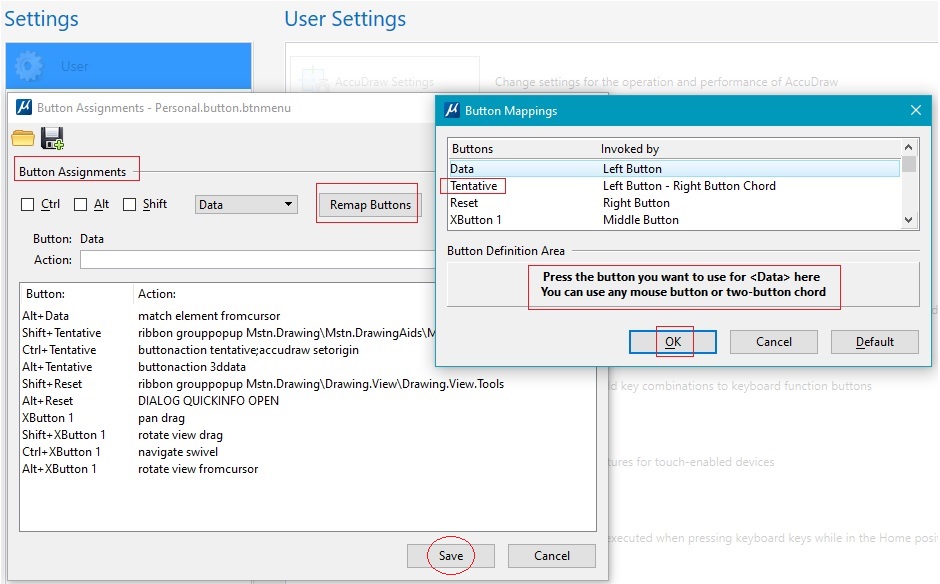

Cannot tentative snap to any element.
- Snap Lock is not enabled
- Button Assignment is not set correctly for Tentative.
- Button set for Tentative in MicroStation is not set as a button in Mouse Properties.
(V8i) To Enable Snap lock:
Note: Save settings/ or press Ctrl+F, is needed to retain setting.
To Set the Button assignment correctly :
To Set mouse properties so that tentative button is set as a "Button"
(these steps may vary depending on Operating System and/or Mouse hardware /driver)
