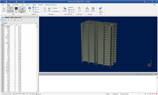

1. New ADINA integration. RAM Elements can export now the structural model to ADINA creating an AUI Input File (*.in). This file contains the commands from AUI Commands Reference Manual Volume 1 to 5 (ADINA, 2022) to generate all the structural elements and loads conforming the structural model.
Figure 1. Export ADINA Input file option in RAM Elements.
Please check RAM Elements documentation to see the integration limitations.

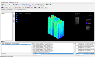

Figure 2. RAM Elements model exported and analyzed in ADINA

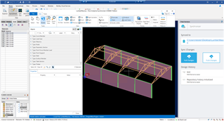

2. Update iTwin Analytical Synchronizer workflow to sync lumber and masonry materials.
Figure 3. Lumber and masonry materials now being synchronized

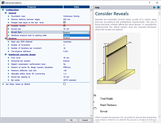

4. Tilt-Up wall module enhancements. New option to define the reveal face to be either the interior or exterior face of the wall.
Figure 4. Reveal face option

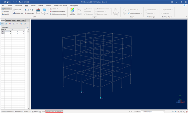

5. Status bar shows distance between two nodes selected. If several nodes are selected, the distance is considered between the first and the last node selected.
