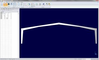

AISC Design Guide 25: Tapered member analysis and design improvements are provided in this version. A new state-of-the-art tapered finite element with exact stiffness is used for the analysis of I-shaped web tapered members. The design is based on the AISC/MBMA Design Guide 25 for the design of web-tapered members recently published. An excellent tool for metal building designers.
