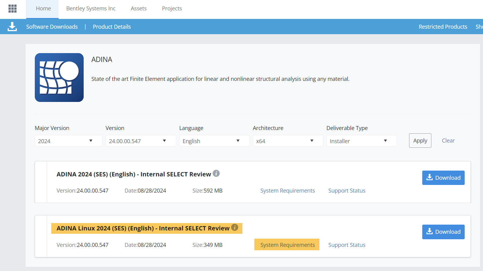

Obtain the installation files from Software Downloads.
Be sure to select the ADINA Linux 2025 (SES) and confirm the System Requirements = Linux

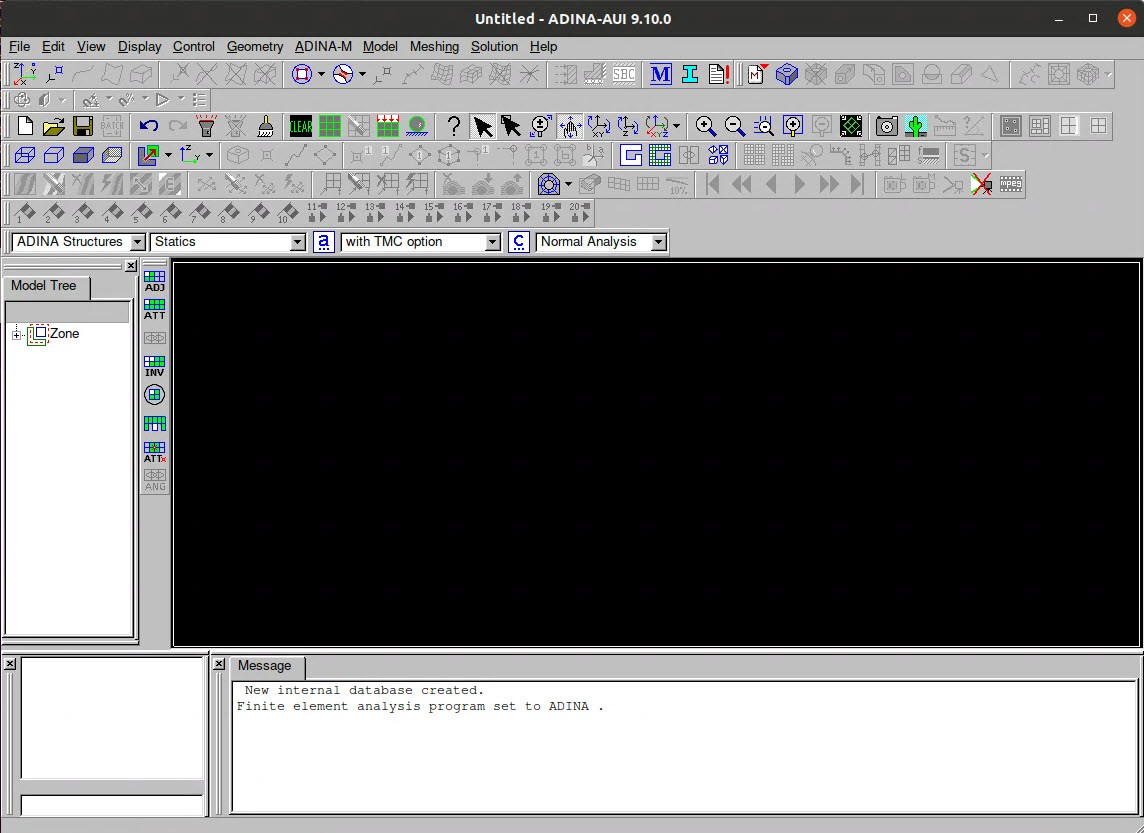

13) Once the PATH variable is set up correctly, you can change directory to any directory, then invoke the AUI with the command:
aui25.00

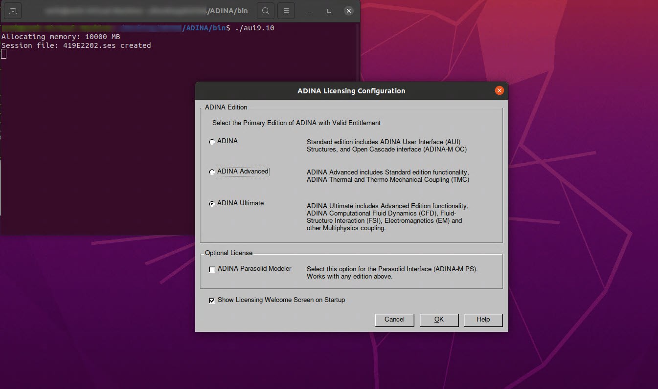

Running the First Time
There are three ways to invoke aui25.00. Each way involves navigating to a directory in which you have write privileges. Call this directory the "working directory". It is assumed below that you have already navigated to the working directory.
1) If the PATH variable does not include the directory containing the ADINA scripts, then type
/opt/adina24/ADINA/aui25.00
The absolute pathname is required here. Substitute the actual absolute pathname if ADINA is not installed in /opt/adina24.
2) If the PATH variable includes the directory containing the ADINA scripts, simply type
aui25.00
3) A third alternative is to copy the script aui24.00 from ./bin/ADINA to the working directory, then type
./aui25.00
The other *25.00 scripts can also be copied.
Next, the ADINA Licensing Configuration dialog will be presented:
Select the appropriate ADINA Edition and if using the optional ADINA Parasolid Modeler also check that option. We recommend Showing the Welcome Screen on Startup for at least the first few times. It is important for selecting different ADINA Editions or the optional ADINA Parasolid Modeler (also known as ADINA-M/PS).
To control the ADINA Edition directly from the terminal, add the one of the options below:
/opt/adina24/ADINA/aui25.00 -ae 1  launches the AUI with the standard ADINA license, the default.
/opt/adina24/ADINA/aui25.00 -ae 2  launches the AUI with the ADINA Advanced license.
/opt/adina24/ADINA/aui25.00 -ae 3  launches the AUI with the ADINA Ultimate license.
Click OK.

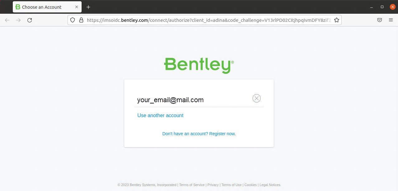

This will launch a Firefox browser window where the user will need to Choose an Account and sign in using the Bentley CONNECTED User email address and password.
Note, we use two-factor authentication so there may be an additional requirement to enter a code via text message.

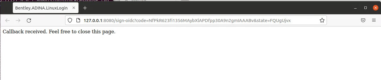

Once the sign in is complete a second browser window or tab will appear indicating "Callback received. Feel free to close this page."
And the program should launch.

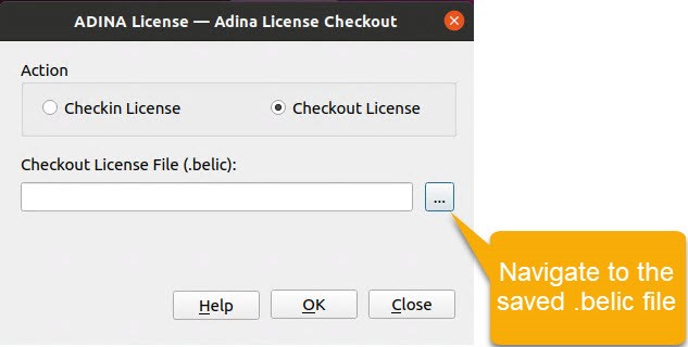

Checking out a License
It is not generally required to check out a License with ADINA.
If the system is offline for more than 7 days the ADINA program can still function, but a license file must be copied to the machine and imported.

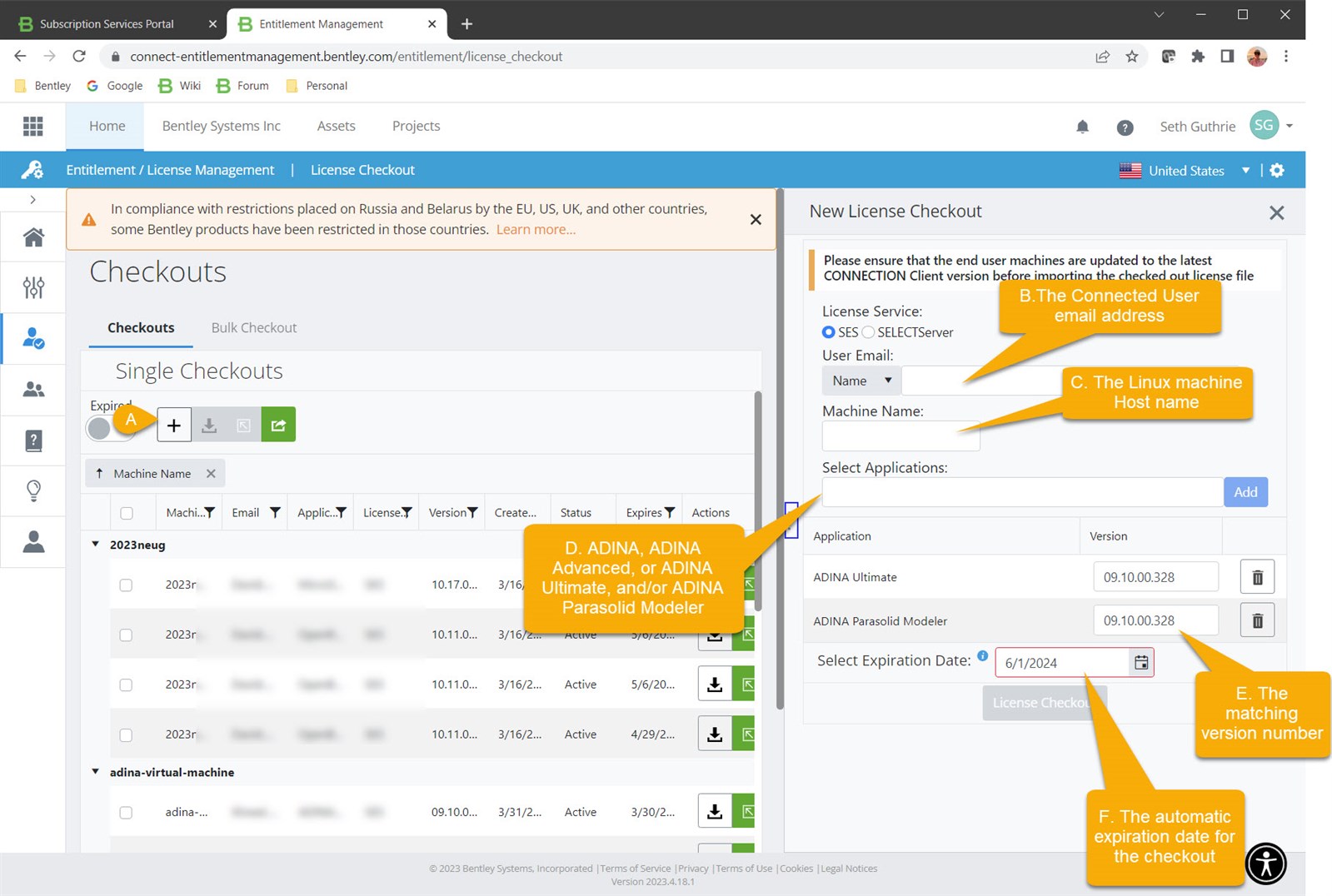

For general instructions for the Administrator to check out a license refer to: https://bentleysystems.service-now.com/community?id=kb_article_view&sysparm_article=KB0019064  The administrator will need a machine with internet access in order to reach the CONNECT Center - Entitlement Management - License Checkout portal.
When generating a license file the Administrator needs to enter the the intended user email address, the machine host name, and the duration of the checkout. A single ".belic" license file can include both an ADINA Edition License and an ADINA Parasolid Modeler license or 2 .belic files can be used. The screen should look like the image below:
Once complete the generated .belic file must be put in a location that the offline Linux machine can access (shared drive, disk, thumb drive etc.).
From the ADINA/bin directory on the Linux machine execute license25.00
In the resulting dialog select Checkout License and then navigate to the saved .belic file.
And click OK.

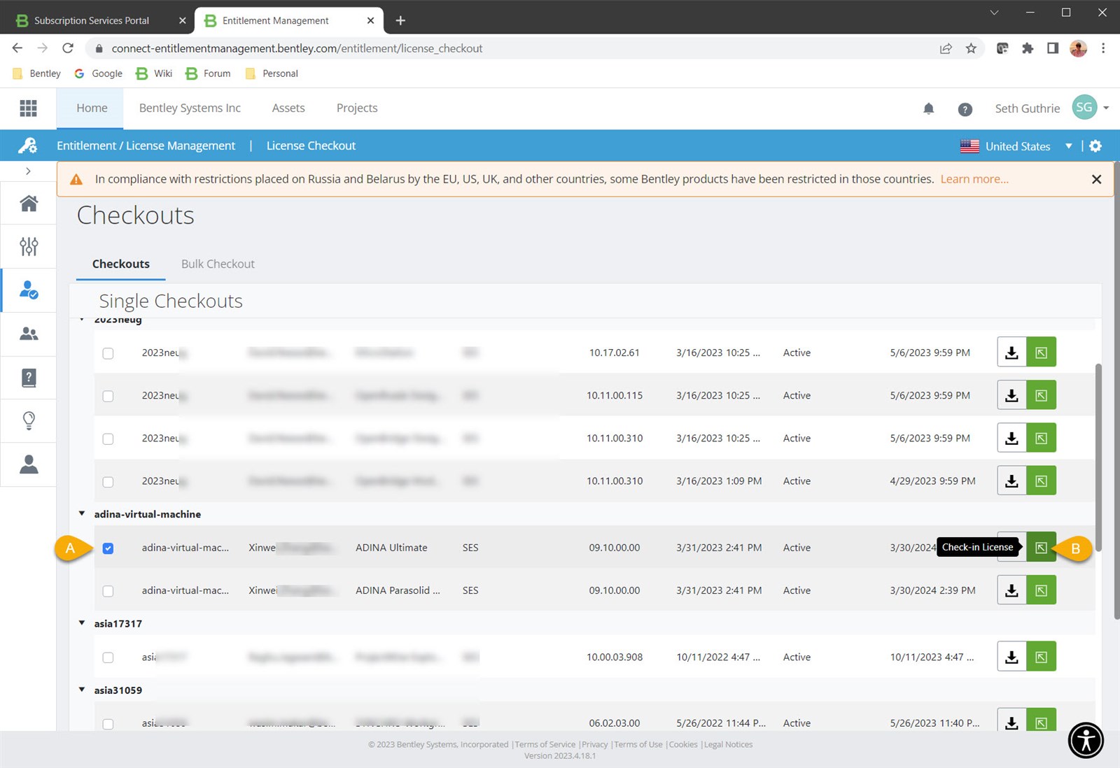

Conversely, a checked out license can be checked in early by selecting Checkin License, but for offline machines the license must be also be checked in through the CONNECT Center - Entitlement Management - License Checkout portal using the green arrow tool.

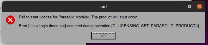

  4. The ADINA program comes with a 7 day trial period. After that trial period, if you try to open any ADINA edition without a valid entitlement you will get an error indicating that aui failed to start the selected license, and the product will shutdown.
This can also happen if the user takes over 2 minutes to sign in.
