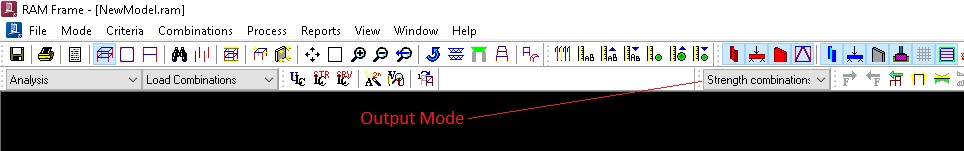

Viewing and reporting of load combination analysis results requires selection of the appropriate load combination type to consider.  Reports and onscreen results only consider the active output mode load combination type.  Similarly, the Frame Shear Wall Forces module has a dialog to select the combination type for envelope results.
