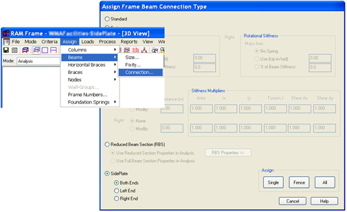

In RAM Frame, Assign the moment connection type using the Assign – Beams – Connection command.

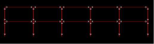

Selecting “Both Ends” and “All” will assign a SidePlate connection at both ends of every lateral frame beam.  If there are lateral beams that are fixed-pinned as shown below, select the “Left End” or “Right End” and Assign those specific beams using the Single command. Generally the beams will have SidePlate connections on both ends.

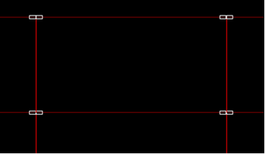

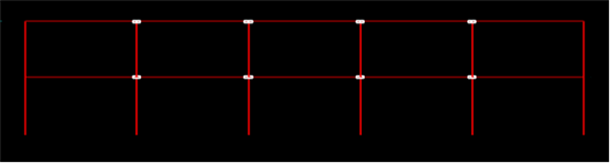

Once the beam ends have been assigned, RAM Frame will display a white rectangle symbolizing a SidePlate moment connection as shown below:
Close up of moment frame above

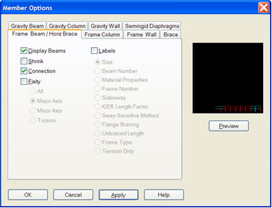

To maintain the SidePlate moment connection symbol display, simply check the Connection box on the Frame Beam / Horiz Brace tab of the View – Members command:

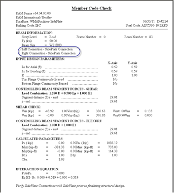

The Member Code Check report for the beams indicates that the beam has SidePlate connection(s):
