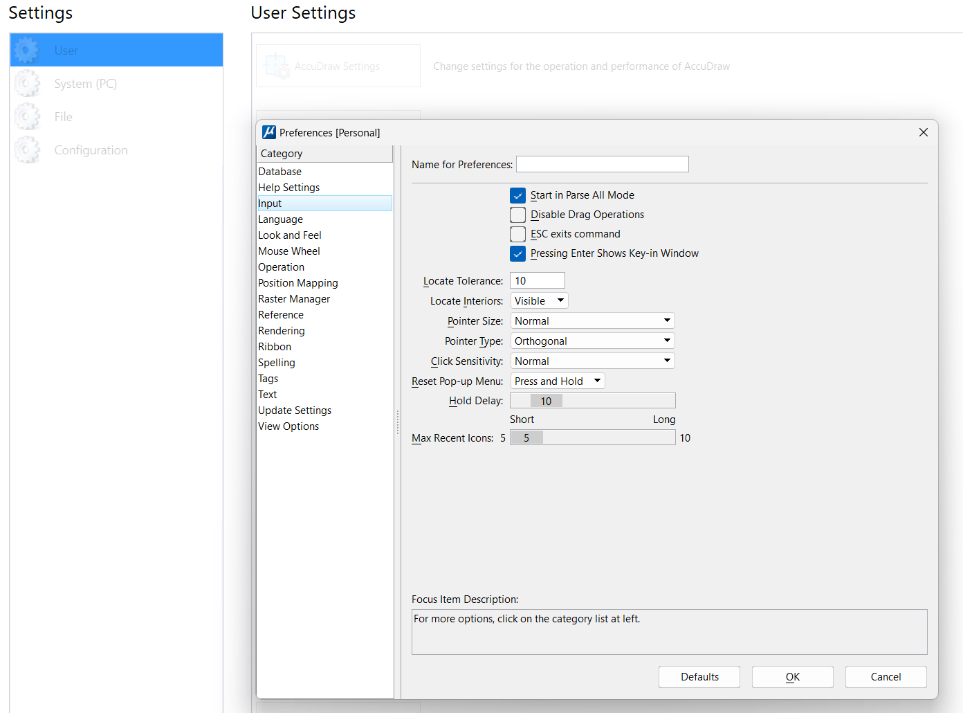

Semicolon between words not seen.
Keyin strings with multiple keyins, separated by a semicolon are not respecting the semicolon as a separator.
eg. set construct toggle; selview all; update all

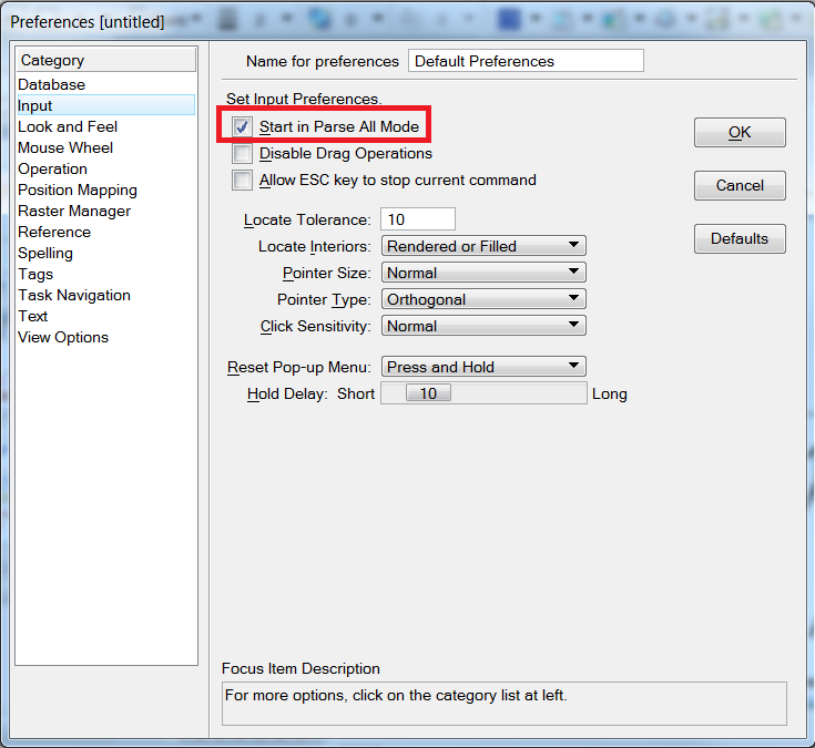

In MicroStation V8i version:
1. From within MicroStation, Go to Workspace > Preferences
2. Choose the Input Category
3. Check on the Option for Start in Parse All Mode
4. Click OK to close the dialog
5. Close out and restart MicroStation
In MicroStation CONNECT/MicroStation 2023:
Go to: Settings > User > Preferences > Input > Start in Parse All Mode and follow the steps as above.
