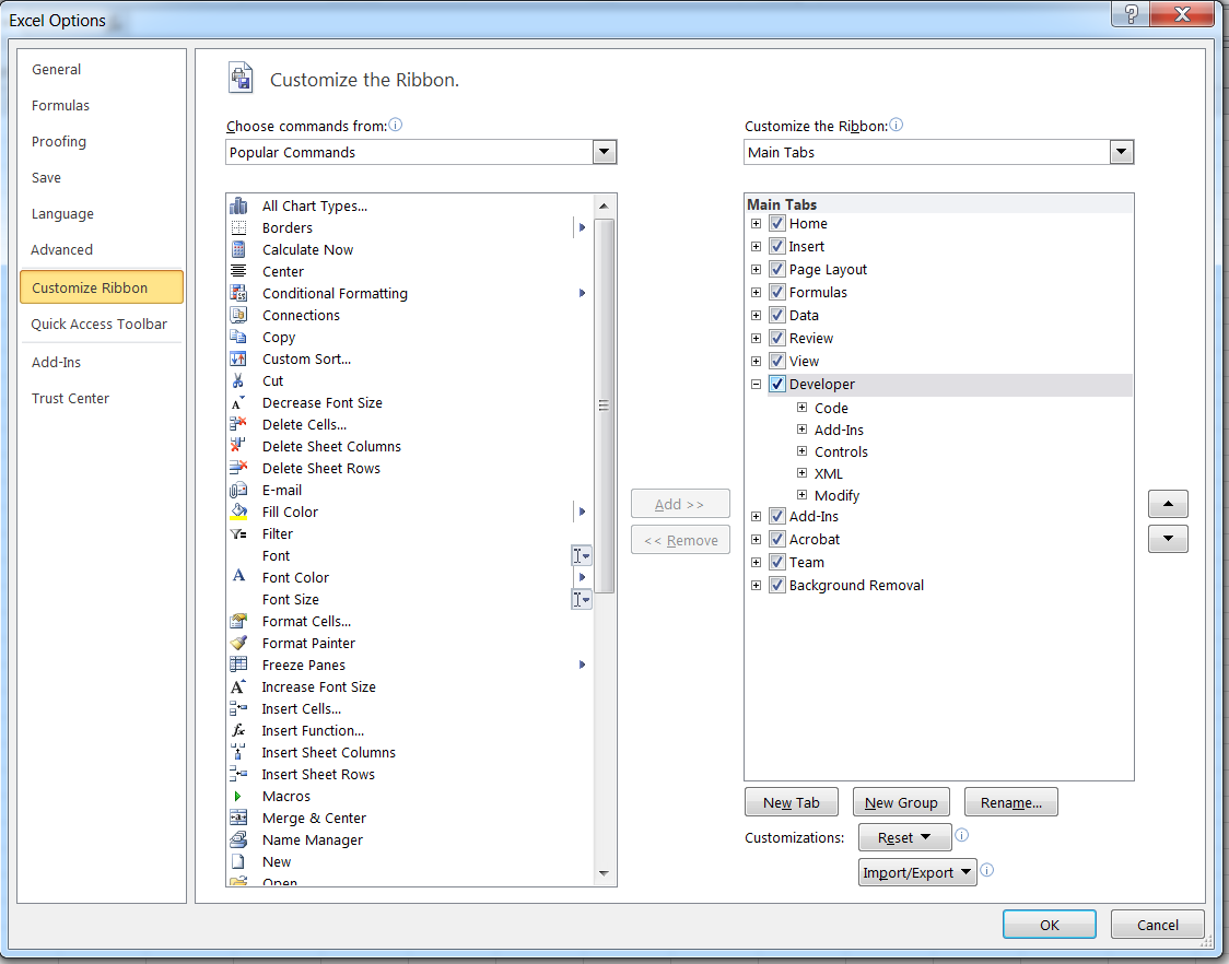

  1. Ensure the “Developers” Ribbon is displayed. File->Options->Customize Ribbon, and check “Developers”

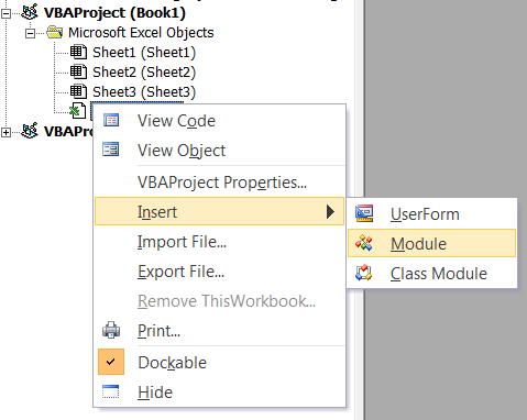

  2. In the developer tab go to “Visual Basic”, and your should see the VBA Code Editor
  3. Right click “ThisWorkbook” and insert a new module

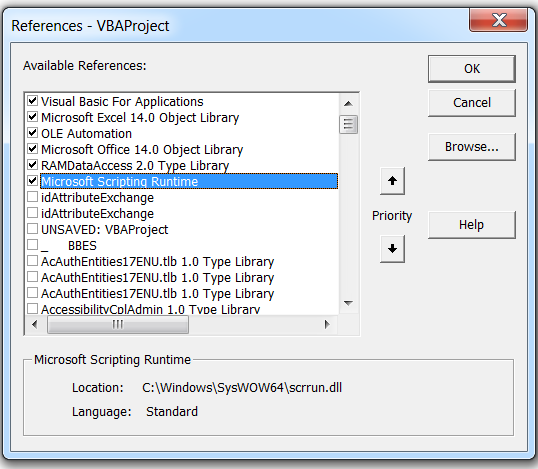

2. Our code will reside in this new module. Go to Tools – References and select ‘RAMDataAccess 2.0 Type Library’ from the ‘References – VBAProject’ dialog box. Adding this reference to your application creates a library of the functions and constants that are available in RAM DA. Also select Microsoft Scripting Runtime, as this will allow us to use “Dictionaries”. Dictionaries are a handy Key Value Pair storage system.
