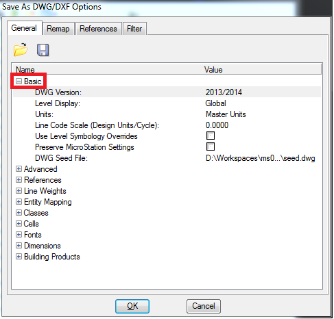

- Expand the Basic heading as shown in Image 1

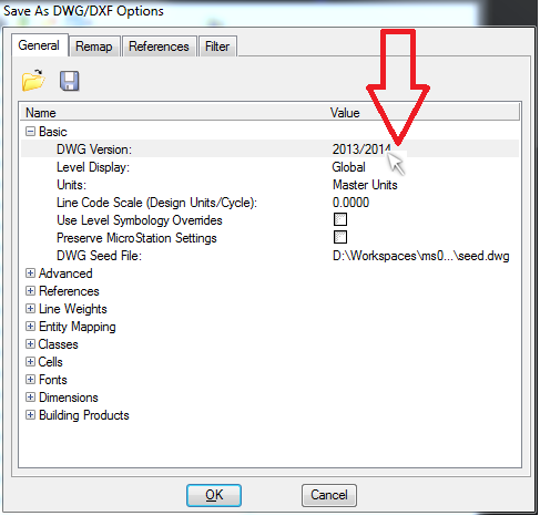

- Beside 'DWG Version', left click on the value shown - see image 2

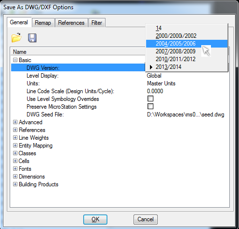

- Select the desired version from the pop up list (e.g. 2004/2005/2006) - see image 3

Image 1 - Basic heading in General tab of DWG options

Image 2 - Left click on Value field

Image 3 - Select DWG version
