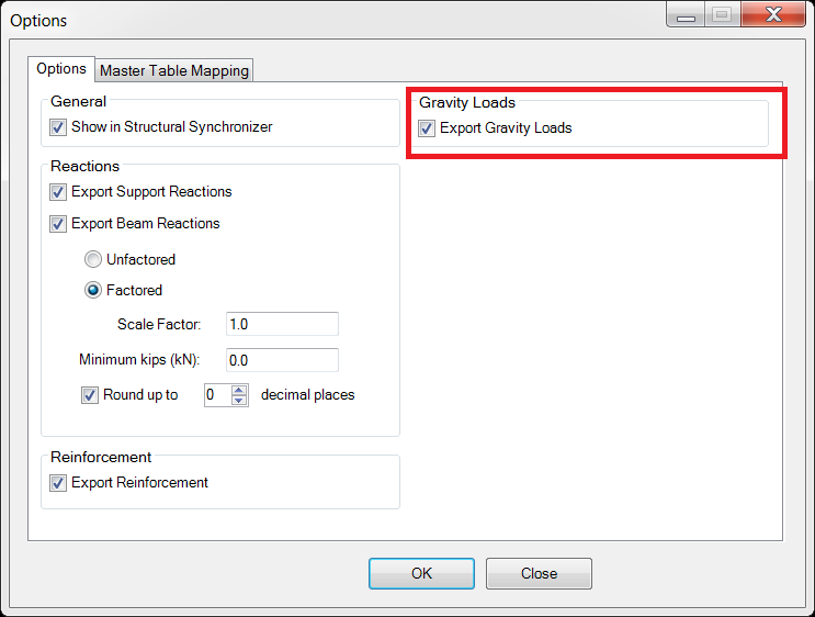

Ram Structural System can now export its applied gravity loadings to ISM.

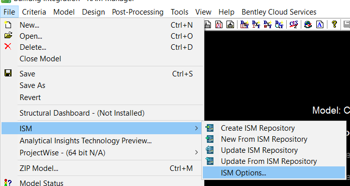

Under File --> ISM --> Options.
 There is now a checkbox option to Export Gravity Loads.

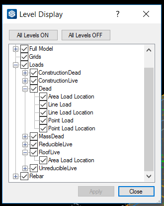

In Structural Synchronizer, Loadings can be viewed or isolated per load cases. Level Display allows you to selectively show and hide different layers.
Loads, Load Cases and type of Loads (Point, Area or Line), can be selected.

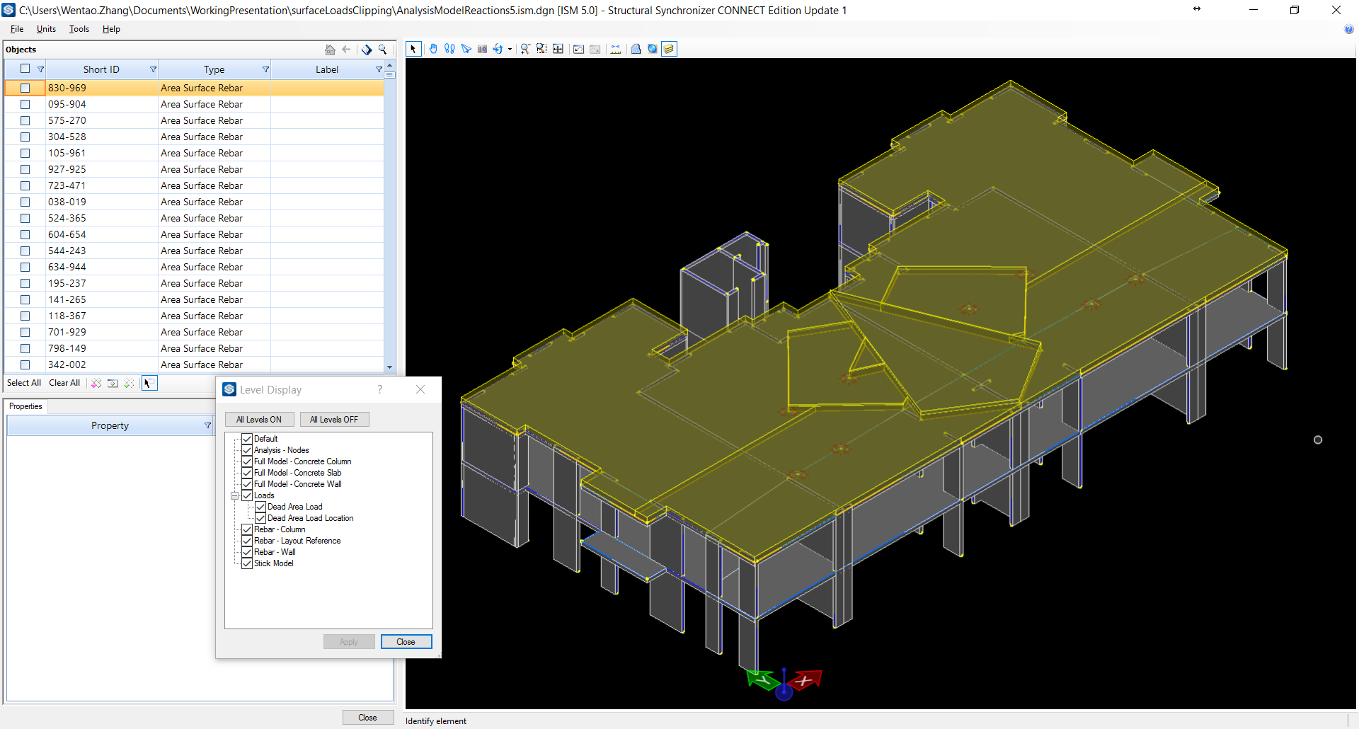

A sample model with Surface Loads as Defined in Ram Structural System and its corresponding view in ISM (Note that Surface Load Polygon Priority is enforced).
Corresponding View in Structural Synchronizer
