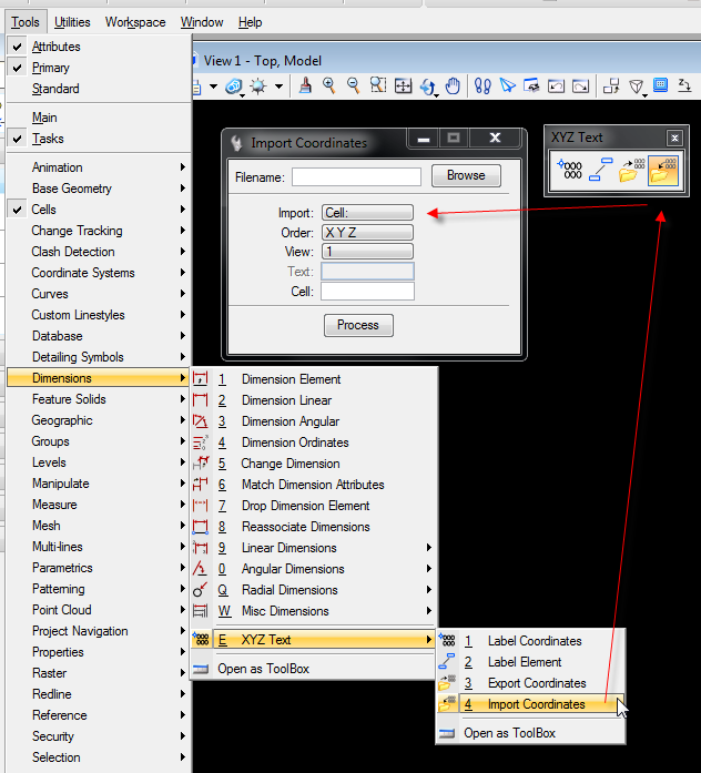

User has a .txt files which contains X,Y, Z co-ordinates and would like to bring all these points into a DGN files.
Use the Import Co-ordinates tool from the XYZ Text.
Select:
Tools>Dimensions>XYZ Text>Import Coordinates
