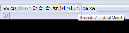

When two-way deck, semirigid diaphragms or lateral walls are present in the model, Ram Frame will go through a meshing process when you start the analysis. You can also start the meshing process by using the View - Meshed floors, View - Meshed walls or Generate Analytical Model tools.

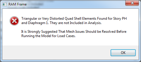

Triangular or Very Distorted Quad Shell Elements Found
This particular warning became more pronounced in version 15.04 as presented in the warning above. Prior versions listed such warnings in the meshing log only. A distorted mesh does not generally cause the program to malfunction, but the mesh of the deck (and walls) should be reviewed in these cases. Adjustments in the mesh size or other parameters set under Criteria - Diaphragm can sometimes resolve it.

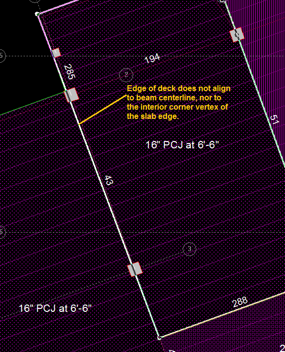

Deck Layout
Typically, these errors are related to the deck polygons (or occasionally the surface loads). Excessive overlapping polygons and subtle overlaps between polygons can cause problems for the program algorithms. Also, deck polygons that do not align with beam and wall center lines or do not extend to the slab edge will cause problems.
To diagnose these types of issues, in a copy of the model apply a deck to the entire floor. That will delete the existing polygons and should resolve the meshing issue. Then, carefully go back and remodel the partial polygons. Enter Ram Frame and generate the analytical model after each modification to make sure the problem has not returned.

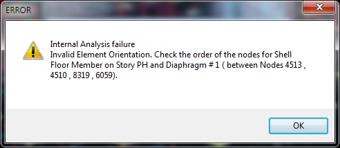

Invalid Element Orientation.
In some cases the semi-rigid diaphragm will mesh successfully but, on close examination, the nodes of the diaphragm will deviate vertically from the nodes of the frames or walls which will lead to a model instability.

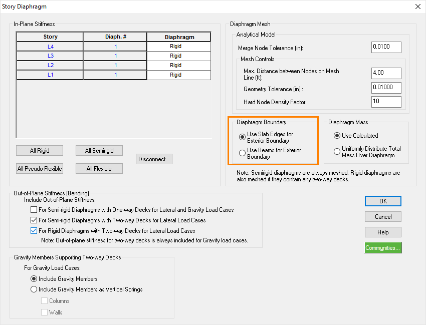

Perimeter Beams (framing) vs. Slab Edges for Diaphragm Exterior Boundary
When a structure has a complete perimeter of beams or walls the user can simplify the meshing of the diaphragm by terminating at the perimeter beam center line. This is controlled by the Criteria - Diaphragms - Diaphragm Boundary setting by using the second option. "Use Beams for Exterior Boundary". This is recommended for semi-rigid diaphragms with small slab edge overhangs in particular.
On the other hand, if the model is a free form, 2-way deck without a continuous perimeter then it's important to only use the first option, "Use Slab Edges for Exterior Boundary".

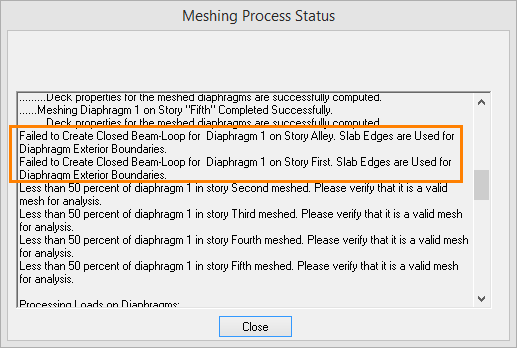

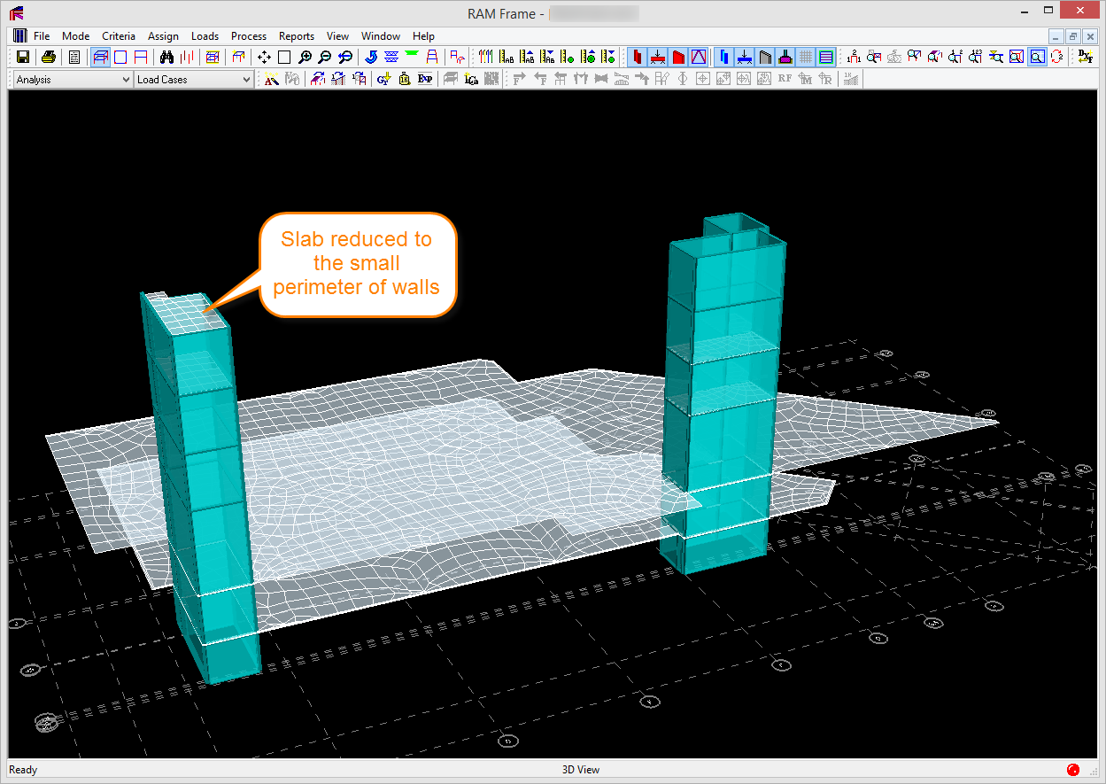

In rare cases a large slab might be clipped back to an interior elevator core only (inverted meshing) when the beams options is used. This generates a warning in the meshing dialog easily overlooked.

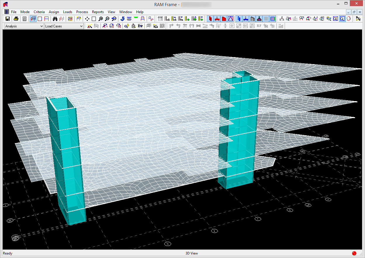

Example of a diaphragm that is properly meshed to the exterior slab edges
Example of a diaphragm that is excessively clipped to a small set of walls that define a "perimeter"
Regardless, always use the control View - Meshed Floors to visually inspect the resulting floor mesh before running the analysis.

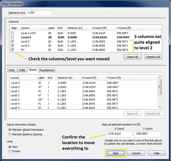

These misalignments are most common in imported models and usually where the end of a brace misses the beam/column joint or where the columns do not align between stories. A good way to identify if there are close nodes is to view the node numbers graphically in plan and elevation. If you have two numbers that appear to be on top of each other as shown below, then you know there are two nodes very close to one another. These issue cannot typically be resolved with changes in the mesh criteria since the beams and braces themselves are the source of the problem. The merge node tolerance should never be set larger than an inch.
To resolve the issue, go to Ram Modeler and review the member end coordinates using the Layout – Show, or the Integrity - Align commands. Them move, align or replace the offending members being careful to snap to key points like grids.

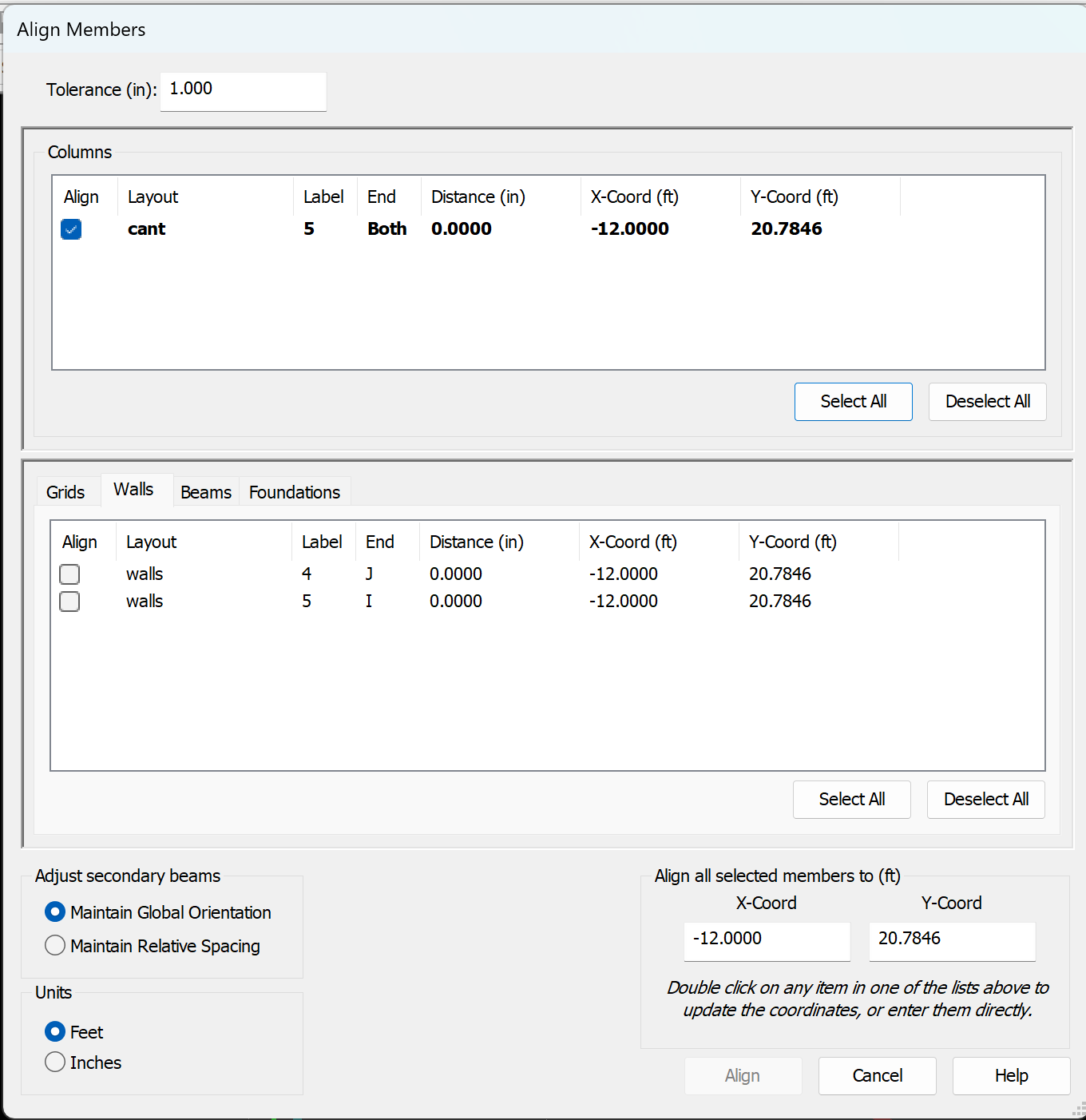

In the Modeler under the integrity menu are two powerful commands, Align Columns and Align walls. These tools allow you to reposition walls or columns on some or all levels so that they align through the height of the structure. The objects can be aligned to one another, or to a grid intersection or any user provided coordinate.
This is similar to moving grids. When the supports are moved all of the supported framing is also adjusted or stretched. Since this can have unexpected effects, it's always best to back up the file before using these adjustments.
