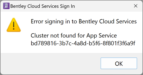

The cloud engine used in RAM Concept v08.00.00 through RAM Concept v23.00.01 was deprecated at the time RAM Concept 2024 was released. This deprecation prevents users from opening the Optimization Manager or starting/resuming optimizations in versions older than RAM Concept 2024. A Bentley Cloud Services Sign In error is displayed in RAM Concept v08.00.00 through RAM Concept v23.00.01 when attempting to perform these operations.
