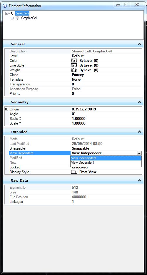

Only shared cells of the cell type Point can be placed as View Independent by default.
Graphic shared cells are placed by default as View Dependent which can be subsequently changed in Element Information to View Independent.
