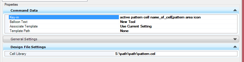

3. Select the new Tool and in the Properties section under 'Command Data' and the keyin:
    active pattern cell name_of_cell;pattern area icon
    (In the above keyin replace name_of_cell with the required cell name you wish to pattern with)
4. To ensure the cell library containing the cell is attached to the opened design, right mouse click on the customize dialog and select Add > Design File Settings > Cell Library. In the Cell Library add the path and name of the cell library containing the pattern cell.
    ( Alternatively the keyin could be expanded to attach the cell library using the keyin RC=S:\path\path\pattern.cel )
