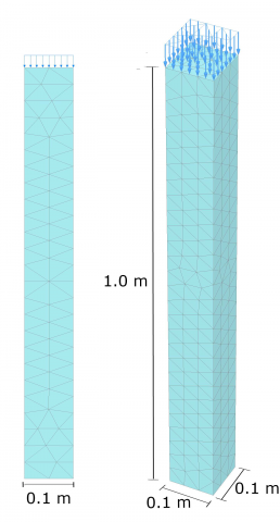

One-dimensional consolidation
Application PLAXIS 2D
PLAXIS 3D
Version PLAXIS 2D
PLAXIS 3D
Date created 15 November 2012
Date modified 15 November 2012
This document verifies that the principles of consolidation are correctly implemented in PLAXIS. The problem involves the time-dependent solution of one-dimensional (1-D) consolidation.
