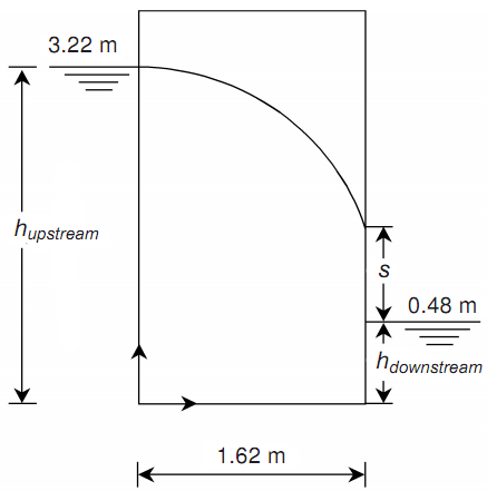

Dam with vertical faces (Muskat problem) with unconfined groundwater flow
Application PLAXIS 2D
PLAXIS 3D
Version PLAXIS 2D
PLAXIS 3D
Date created 18 January 2013
Date modified 18 January 2013
This document describes an example that has been used to verify the groundwater flow capabilities of PLAXIS. In this example a vertical cross section of an unconfined groundwater flow system in a homogeneous earth dam underlain by an impervious base is considered (see figure). Such a problem is commonly known as the Muskat problem where the free phreatic surface and the seepage face are unknown, leading thus to a set of nonlinear equations.
