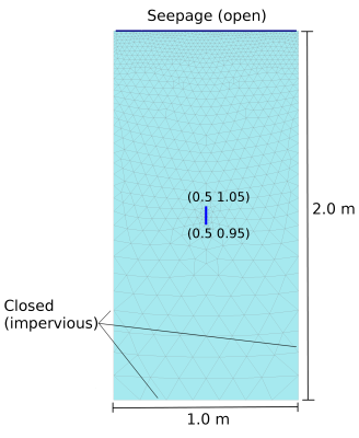

This document verifies that groundwater flow principles are correctly implemented in PLAXIS. A soil column with a well inside is simulated. Under constant infiltration conditions, the total discharge from the top soil boundary is calculated in PLAXIS.
