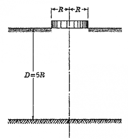

In this case a flexible tank on elastic saturated soil is tested. The test includes the verification of the settlement of the centre of the tank for the condition of homogeneous, isotropic soil of finite depth in PLAXIS.
