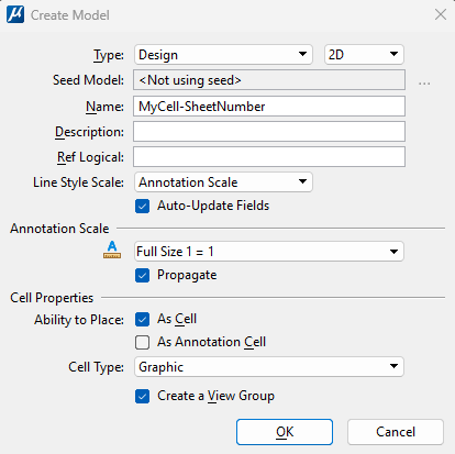

Create a new Cell Library, or use an existing one, to create this new cell.

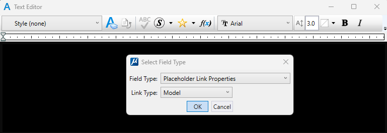

Place a Text Field using the Placeholder Link Properties option with Link Type as Model. This will be used to point to the Sheet Number of any external model.

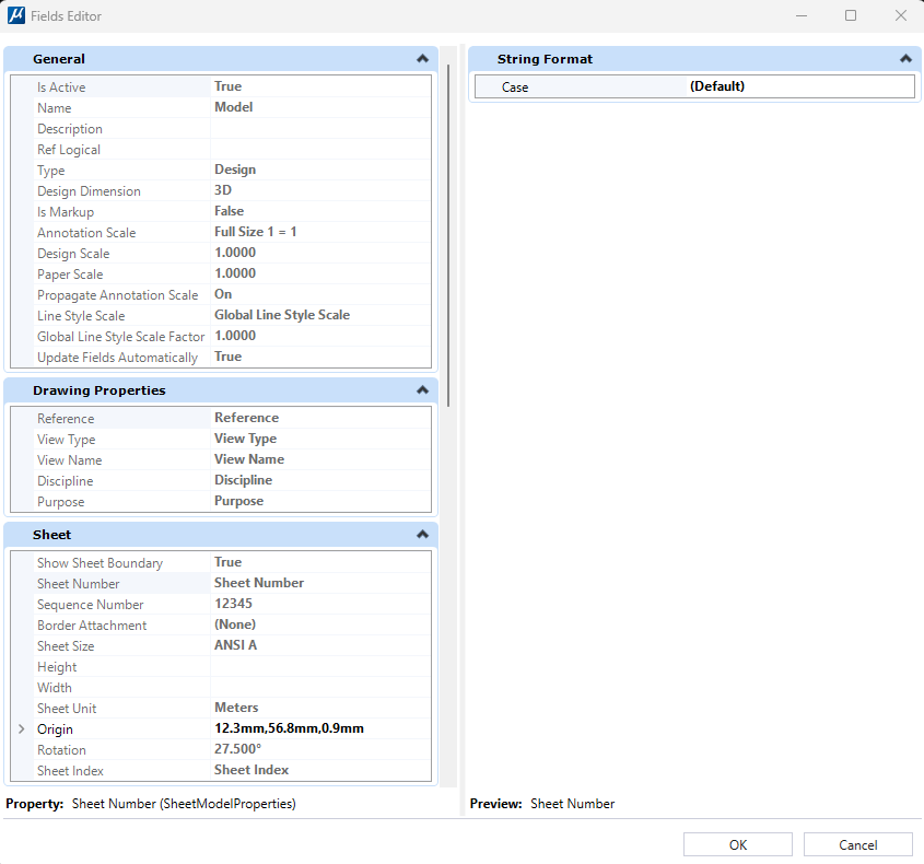

When the Fields Editor dialog appears select the Sheet Number option from the existing model. This will be used in the future to link to any external design file model to display the Sheet Number information.

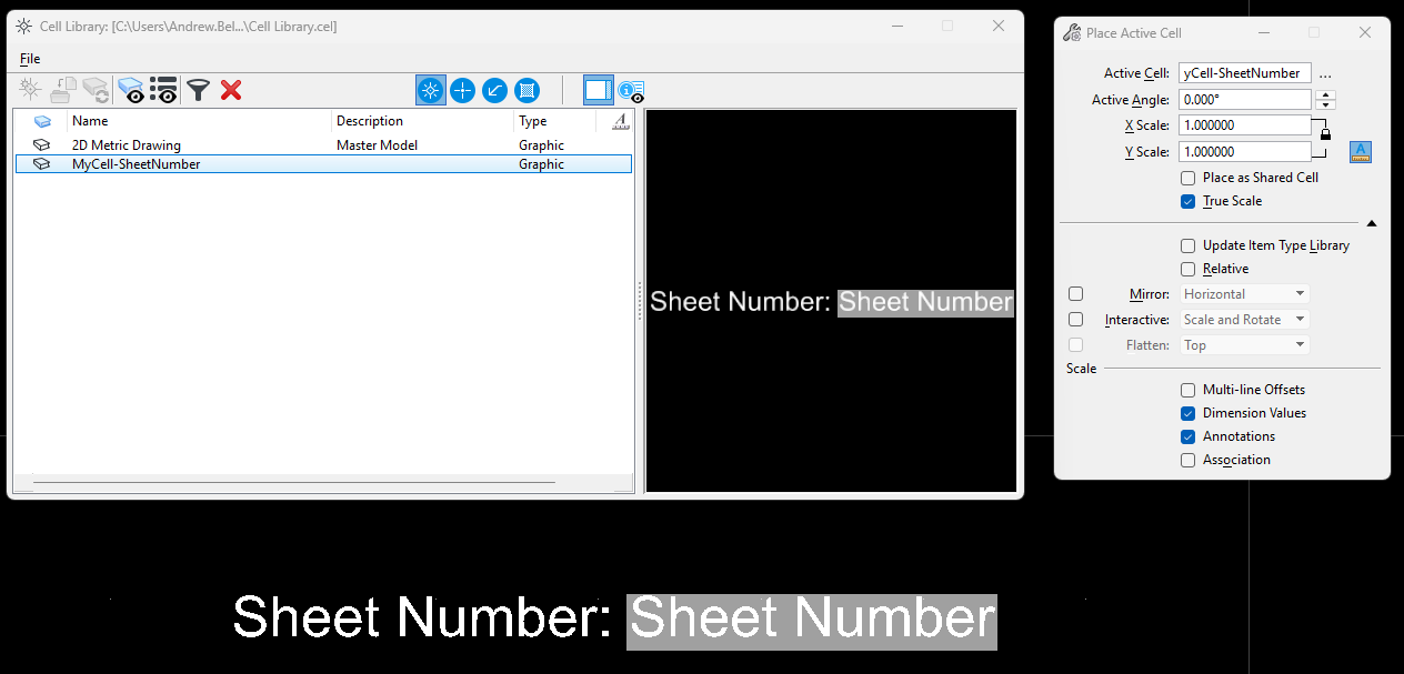

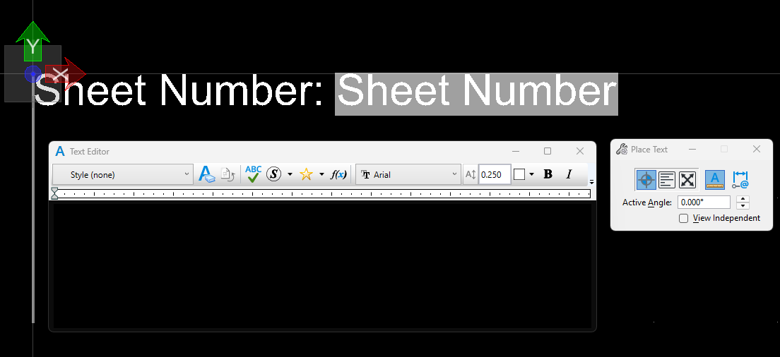

Place this text in the Cell that you've created so that it is snapped to the center of the model on the ACS Triad.

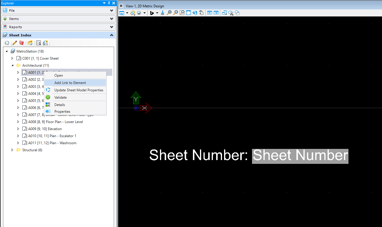

Open the Explorer tool dialog and list all the Sheet models under the Links section. Right click on the chosen Sheet Model and select the menu option Add Link To Element.
Step Seven
Click on the Cell you've placed for the Sheet Number and you will see the text change to that of the Sheet Number from this model.
