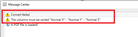

Trying to convert an .XYZ point cloud to .POD you get the following error message in the Message Centre: The Columns must be sorted: Normal X - Normal Y - Normal Z
Please make sure that the last three columns are sorted as Normal X - Normal Y - Normal Z
