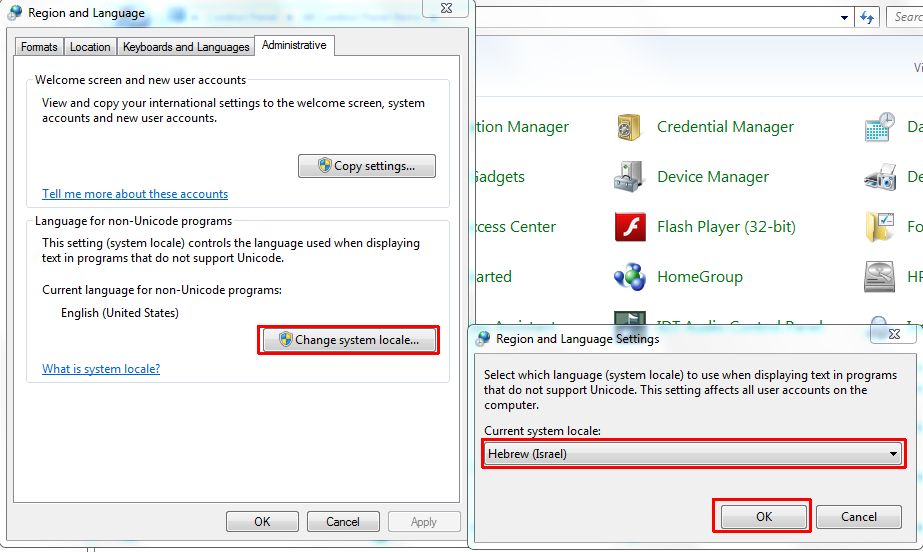

Hebrew characters are displayed backwards.
1. Go to Control Panel > Region and Language (In Windows 8.1 its Region)
2. Navigate to the Administrative tab
3. Under Language for non-Unicode programs, go to Change system locale and set Current system locale to Hebrew (Israel)
4. Apply and Close dialog
5. You must restart Windows for the changes to take effect
6. When you open the DGN file characters are displayed correctly.
