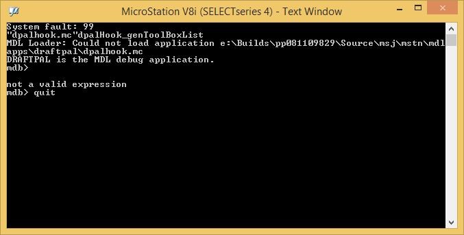

When User tries to load the Tool Boxes dialog with the following options, MicroStation crashes.
Shortcut: Ctrl + T
Key-in:   mdl load draftpal; draftpal opentoolbox
Menu:     Tools > Tool Boxes
Text Window displays the following error message
How to Avoid
  1. There was an additional copy of Bentley.PowerPlatform.FeatureAspects.dll in the following folder.
    C:\Program Files (x86)\Bentley\MicroStation V8i (SELECTseries)\MicroStation\mdlapps\
  2. Delete this file Bentley.PowerPlatform.FeatureAspects.dll from the above location, to avoid the crash.
