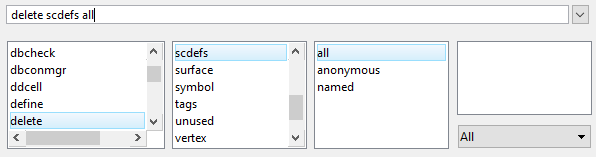

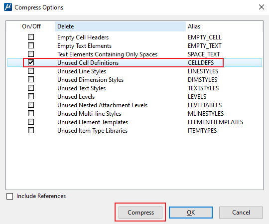

How can I delete unused shared cell definitions in my design file?
Key-in "delete scdefs all" and press Enter to delete all unused shared cell definitions present in the design file
or navigate to File > Tools > Compress Options, toggle "Unused Cell Definitions" to ON, and then select Compress to delete all unused cell definitions.
