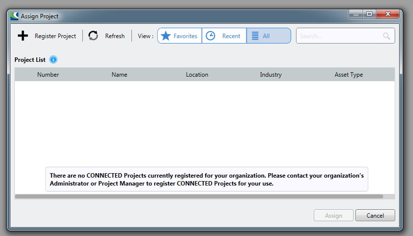

Turn off the "Assign Project" window in MicroStation V8i
 Product:MicroStation
 Version:V8i
 Environment:N\A
 Area:Configuration
 Subarea:General
How to turn off the "Assign Project" window, that comes up each time MicroStation V8i is started?
Adding the configuration statement:
_USTN_CONNECT_PROJECTGUID = 00000000-0000-0000-0000-000000000000
to
a) individual Project Configuration Files (PCF)
b) a global CFG file such as Standards.cfg
will stop this dialog appearing.
Solution b) is the most convenient way to prevent the prompt for all projects.
