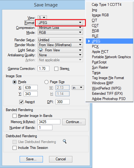

Yes you can save a DGN to an image by going to the Utilities > Image > Save.
When that dialog opens you will see the option for format to export to.
