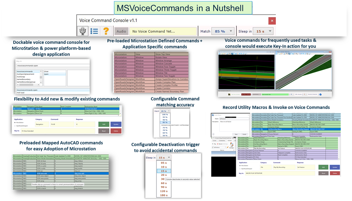

What is MSVoiceCommands?
- It’s a C# base MDL app which works on any MicroStation & MicroStation based design application for ex. OpenRoads,OpenBridge, OpenPlant etc.
- User can give Voice Commands for all generally used key-In tasks like Attach Reference, Show Properties, Window Tile & many many more.
- Application listens to your commands & upon matching command successfully, it performs the Key In action in the background
- Along with MicroStation Voice Commands set, User would get Pre-loaded Voice Commands for some Design Applications like OpenRoads Designer, OpenBridge Modeler, OpenPlant Modeler etc.
- We have introduced concept of *.vc file where default command set is preloaded from file.
- For all the applications: MicroStation.vc command file gets loaded automatically which would be created in local machine automatically upon 1st time usage.
- We have added all the DWG related key-in commands in the MicroStation.vc for AutoCAD Users to easily adopt MicroStation Environment.
- User can also add/edit/delete your commands along with Key In action. You can configure command set suitable for your projects
- User can save lot of time clicking on various options while working
- User can anytime put on Command Console to Sleep or Close commands console

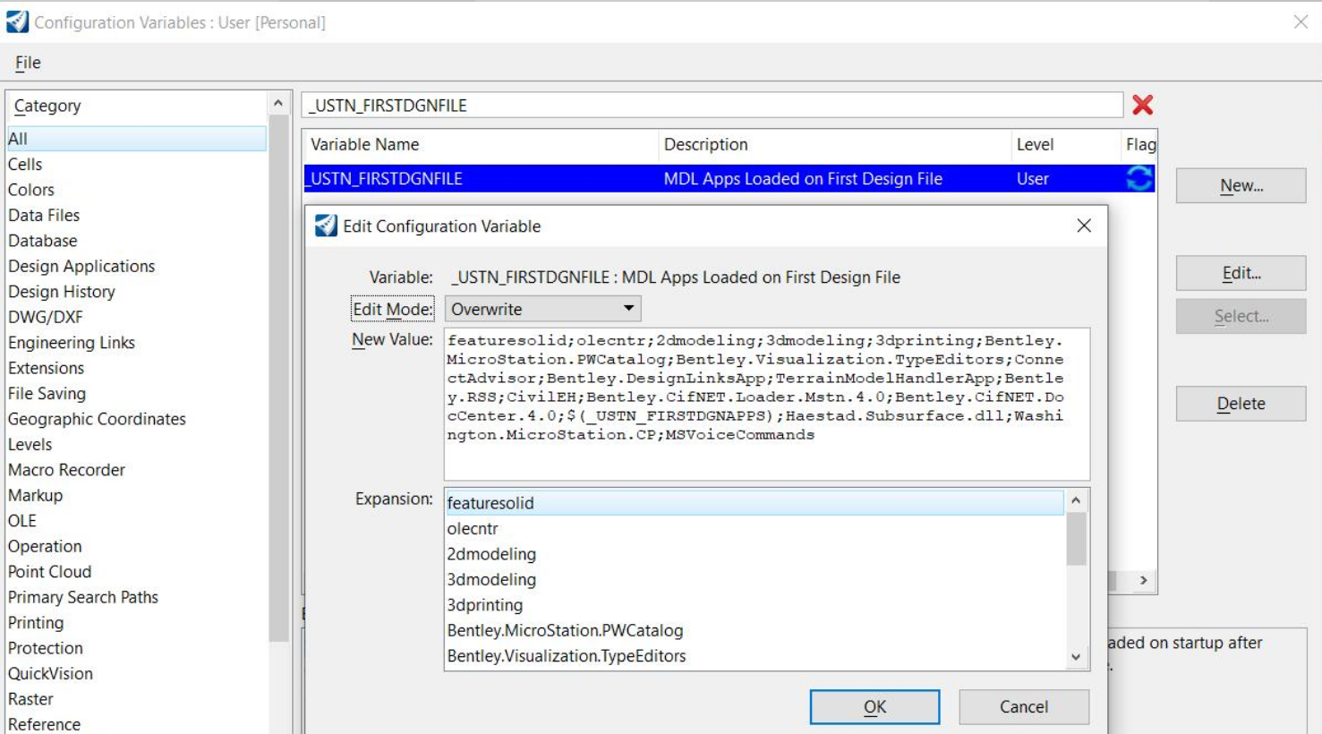

- Add the DLL entry in the Config Variables _USTN_FirstDGNFile so that next time it loads automatically.
