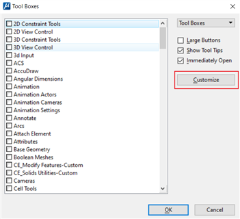

Within this file, navigate to File>Settings>User>Tool Boxes>Customize
Expand "User Tools" and select "Personal.dgnlib" within the selection tree.
Select "New Tool Box" and name the new toolbox as desired.
With the new tool box selected, select "New Tool". Name this new tool as desired. Create as many tool boxes and tools as needed.

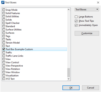

Now open MicroStation again. This time open one of your drawings and press CTRL+T. Locate the new Tool Box you recently created within the list of available Tool Boxes.
Select it and press OK.
You should now have access to your new toolbox/tools that were created in the Personal.dgnlib. Be sure to save settings (CTRL+F) before exiting to keep these customizations in future sessions of MicroStation CONNECT.
