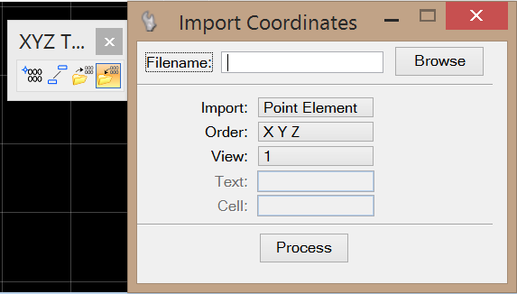

User has coordinate data in a text file that he needs to import into MicroStation.
Use XYZ text. Go to Tools > Tool Boxes >XYZ Text. Select the text file and the order of the data.
The choice of selecting a cell or point to place the location in the file is available. Click import to complete the process.
