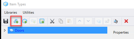

 - Create a new Item Type Library if required, this will be attached to the Parametric Cell Variations later. (Doors in this instance)

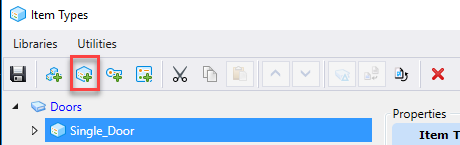

- Create a new Item Type (Single_Door in this instance)

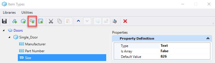

- Create a New Property Definition (Size) to be used to Report on later
- Save the Item Type

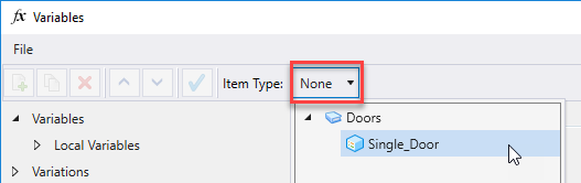

 - To attach the Item Type to the Parametric Cell Variations, open the Variables dialog (Modeling>Constraints>Variables)
 - Select the Item Type: created earlier
- Select a Variation to show its Properties and under the Item Type properties enter the required values for this Variation. ( In this example Size:826 to match the Variation Name )
- Repeat Step 10 for the other Variations
