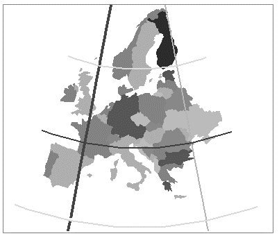

Albers Equal-Area Conic
A very popular projection for maps of the continental United States and used extensively by the U.S. Geological Survey. Developed in 1805 by German native H. C. Albers and is an equal-area projection. It is especially suited for nations like the USA that are wider east/west than north/south. Parallels are concentric arcs of circles, not equally spaced. The meridians are equally spaced radii of the same circle, running at 90 degrees. Normally it is arranged with two standard parallels.

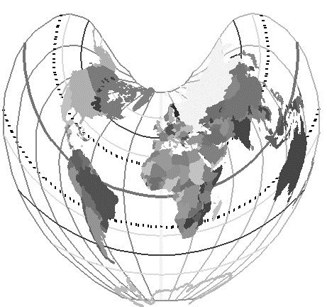

Bipolar Conic
The full name is Bipolar Oblique Conic Conformal Projection. It was developed in 1941 by O. M. Miller and W.
A. Briesemeister in order to create new maps of North and South America and is an adaptation of the Lambert Conformal Conic projection. Bipolar Conic is a conformal projection made up of two oblique conic projections placed beside one another with poles 104 degrees apart. The parallels and meridians cross at right angles but are complex curves.
This projection is supported in the spherical form only.

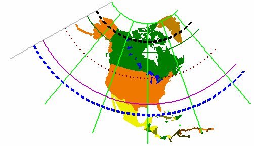

Equidistant Conic
The oldest and most straightforward of the Conic projections. It is also known as the Simple Conic or Conic and has been in use since Ptolemy developed it sometime around 150 A.D. The parallels are arcs of evenly spaced, concentric circles. The meridians cut across the parallels at right angles. Suitable for maps which extend east/west rather than north/south. It is still the projection of choice for many smaller nations.
This projection is also known as the Simple Conic Projection.

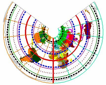

Another projection first developed in 1772 by Lambert. It is sometimes called the Conic Orthomorphic projection. Like the Albers Equal-Area Conic, the Lambert is well suited for areas with a mainly east-west expanse. It is the official projection for the SPCS for States with this geography. (The Transverse Mercator has the same status for States which run mainly North/South.) A number of aeronautical charts use the Lambert. The parallels are arcs of concentric circles, which become more closely spaced as they move toward the center of the map. The meridians run at right angles to the parallels. With two standard parallels, the area distortion is minimal between and near the standard parallels.

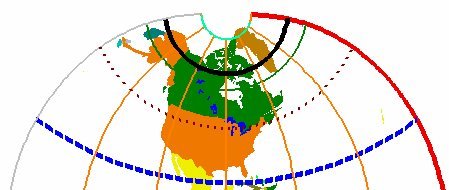

Polyconic
Sometimes known as the American Polyconic, it was for a long time the standard projection for large scale maps of the United States. It was developed in 1819 by F. H. Hassler, the first Superintendent of the U.S. Coast Survey and used extensively until the 1950s. Created as a compromise between an equal-area and a conformal projection, the polyconic has low distortion along the central meridian. The Central meridian is projected as a straight line, while all other meridians are complex curves. Parallels are not concentric, they are arcs of circles. The Equator however is a straight line. In the USA, the polyconic has been replaced by the Transverse Mercator or Lambert Conformal Conic projections commonly associated with the State Plane Coordinate System.
