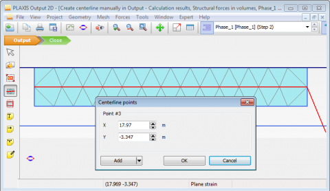

In order to view the Structural forces in volumes in Output, a centerline is required. A centerline can be created manually by selecting points in the model, by adding a centerline from the tunnel designer or by importing *.otnl, *.tnl or *.json files.
In a pop-up window the points to define the centerline can be selected directly in the model. This can be done by using the cursor for the selection and/or manually add the exact coordinates of the points for the centerline. After the last point is added, OK can be clicked to view the forces.
Please note that with this method only straight lines can be created in order to define the centerline.

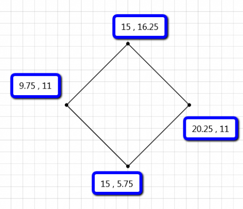

In order to define the points of a centerline, depending on the geometry drawn, a polyline can be used for straight lines and arcs for generating part of an ellipse to form the shape.
A polyline requires the exact coordinates of each point to be defined.
[{"type" : "polyline", "points" : [[20.25, 11], [15, 16.25], [9.75, 11], [15, 5.75], [20.25, 11]}]

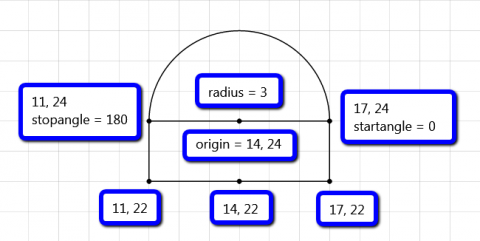

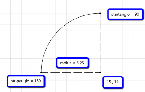

The arc requires the following parameters to be defined:
[{"type" : "arc", "origin" : [15.0, 11], "radius0" : 5.25, "radius1" : 5.25, "startangle" : 90, "stopangle" : 180, "segments" : 10}]
[{"type" : "polyline", "points" : [[11, 24], [11, 22], [14, 22], [17, 22], [17, 24]]}, {"type": "arc", "origin": [14, 24], "radius0": 3, "radius1": 3, "startangle": 0, "stopangle": 180, "segments": 36 }]
