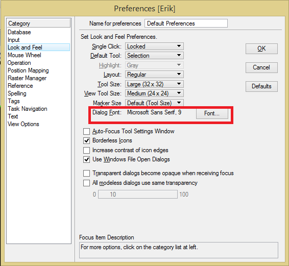

How do I change the font of menus and dialog boxes within MicroStation?
Navigate to Workspace > Preferences > Look and Feel and find the following setting:

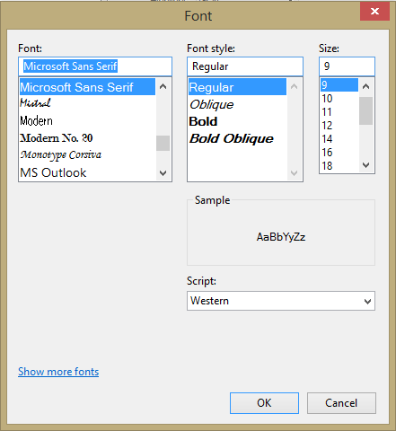

Click Font... and the following box opens:
With this box, you are able to change the size, style, and font of the text used by most dialog boxes in MicroStation.
