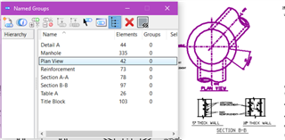

- From the Drawing task Go to > Home > Groups >Named Groups click on the drop down arrow in lower right corner to open the dialog.
- Highlight each Named Group and pick on Select Elements in Named Group
- Each group of elements will be added to a selection set

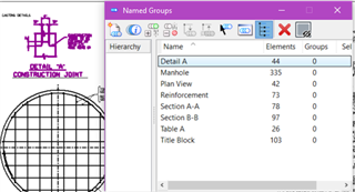

To show you how easy it is to create a Named Group, let’s make one for elements that define the graphics for Detail A.
- Select the New Named Group button
- Edit the name to Detail A
- Create a selection set of the elements that make up Detail A
- Pick on the Add Elements button and accept.

- From the Named Group dialog, highlight Plan View
- Do a Right-Click > Add to Displayset
- Select icon Set Displayset from Selected Named Group
- Do a CTRL+B and turn Displayset OFF.

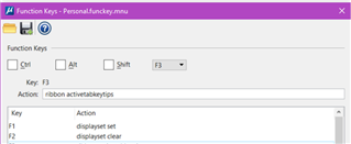

- Finally to really knock your socks off, edit a couple of function keys to toggle Displaysets!!
- Now you can create, recall and display your QuickSets all with a few keystrokes.
