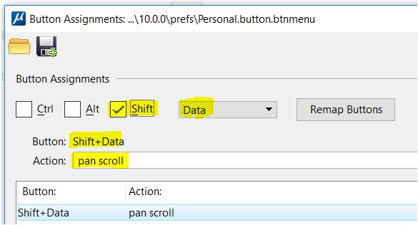

Do you know that by adding a new button assignment (see image) you can now automatically pan the view similar to how this was performed within the older V8 series?
In CONNECT Edition, go to Settings > Users > Button Assignments
In the Button Assignments dialog box
Checked ON "Shift" + Data
Button : Shift + Data
Action : (keyin) Pan Scroll
Click "Save"
