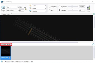

Where are Vue Histories stored
Vue histories are stored in following locations...
WorkSpace/WorkSet  out folder
C:\ProgramData\Bentley\MicroStation CONNECT Edition\Configuration\WorkSpaces\Example\WorkSets\MetroStation\out\Vue History
For No WorkSpace/No WorkSet it gets stored in
C:\Users\{UserName}\Documents\Vue History\
