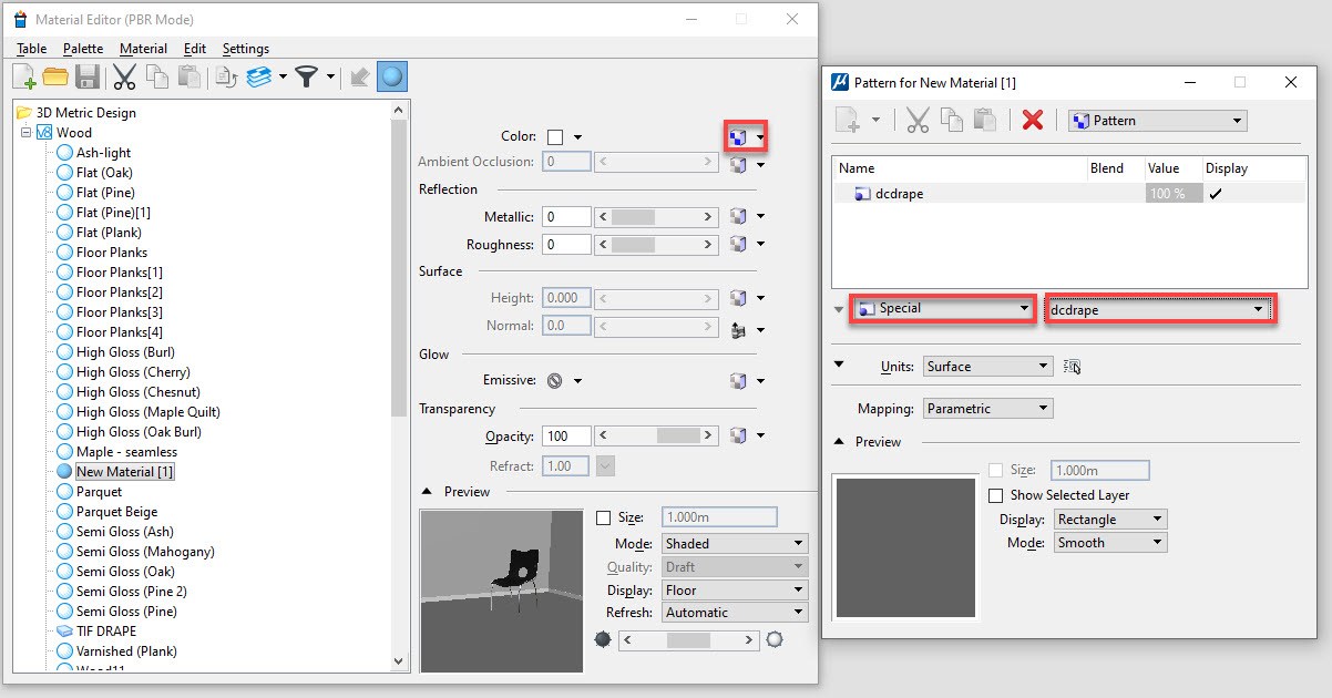

4. Open the Material Editor
    Visualization > Home > Materials > Edit
5. Make a new material
    Material > New
6. In the new material (on the right-side) General tab, click the Pattern Map icon   to open the Map Editor dialog.
7. Change the map type from Image to Special. This gives you the option to choose dcdrape as the pattern map type.
8. Assign/Attach this material to elements you wish to drape with any attached raster file(s) that have Draping enabled.
9. Set the View to one of the Illustration modes or Smooth or Smooth with Shadows
