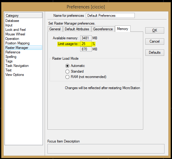

How is possible check and increase the maximum percentage of available memory to use for loading rasters?
  1. Open: Workspace > Preferences > Raster Manager you can see in the Memory tab your "Available memory".
  2. The Limit usage allows you to set the maximum percentage of available memory. By default is 25%. You can increase this amount.
  3. The field below displays the percentage in the equivalent number of MBs
