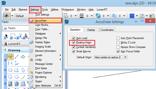

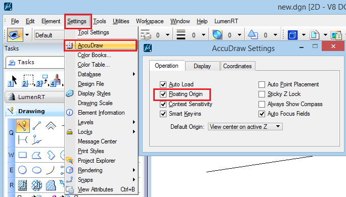

AccuDraw compass is not showing.
Make sure AccuDraw is on, and enable "Floating Origin" in Settings.
V8i (+Select Series):
1. Go to Settings > AccuDraw Settings [AccuDraw settings open]
2. Enable "Floating Origin".
3. Close and go to File > Save Settings.

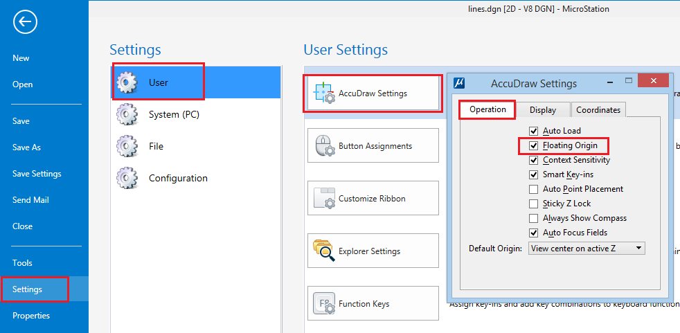

MicroStation CONNECT Edition:
1. Go to File > Settings > User > AccuDraw [AccuDraw settings open]
