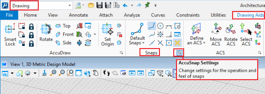

You can enable/disable AccuSnap within the AccuSnap Settings dialog.
In MicroStation CONNECT Edition/MicroStation 202X
Drawing Workflow >> Drawing Aids Tab >> Snaps Ribbon Group dialog launcher
In the General tab, toggle the "Enable AccuSnap" setting. Close the dialog and Save Settings (CTRL+f) to keep changes for future sessions of MicroStation.
The same steps will apply in MicroStation v8i.
The AccuSnap Settings dialog is found via Settings >> Snaps >> AccuSnap
